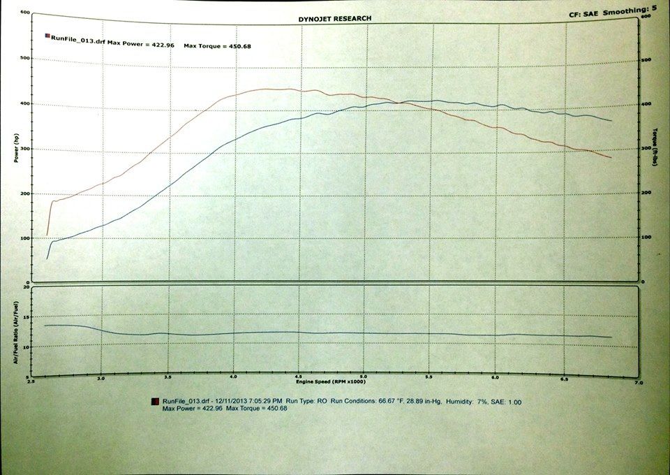

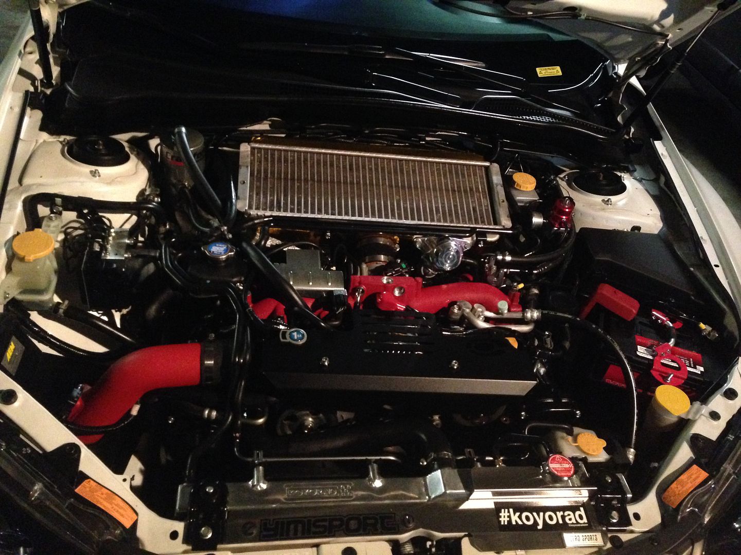

#8 · (Edited)
I have a 2010 STi, lifted a head at 46500 miles during extreme driving. since the motor was coming out, I did a basic build ( I was on E85 and synergy 20g turbo 410/425 tq, synergy 340 fuel pump, ID1000, header, dp, exh)
after the build i decided to do TGV delete as well, also with the following mods (most of the stuff I already had, just changed up the turbo to blouch 20G XT
New stuff:
JE Forged pistons
Scat H beam rods
ACL main/rod bearings
ARP head studs
air pump delete
Motive autowerks composites tgv
aeromotive FPR
setrab 19row oil cooler (with thermostat)
forged motorsport by pass valve
stuff already have:
ID1000 injectors
South Bend SS TZ clutch (rated at 600 wheel tq)
synergy 340 lph fuel pump
ngk 1 step colder
grimmspeed 3 port ebcs
koyo rad
kill b pick up n baffle tray
crawford v2 aos
Blitz Nur-spec exh
GT spec equal length exh manifold
GT spec uppipe
aem intake
invidia catted downpipe
Image Link
E85: 423 HP/ 450 Tq to the wheels, tuned by yimisports SoCal, target boost 24 psi taper to 20 .
Image Link
Nice numbers! How much boost was that (disregard, I'm blind)? I wish my clutch held because I know it would have been up in the 450-460 wtq range. Always next year I suppose. :)
I still think the 20G is just a really fun turbo!
