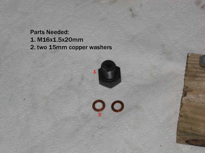

Materials needed
1- m16x1.5x20mm bolt
2- 15mm in diameter washers (check this diameter the washers should fit
inside mastercylinder they should be 1/2 I believe)
brake fluid

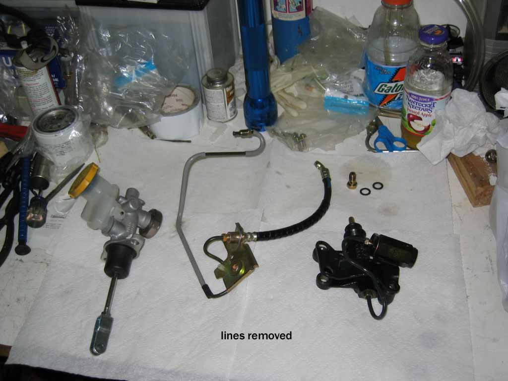

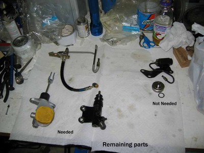

8.) remove Hydraulic clutch system from car
system removed from car.
remove these fasteners.
It should look like this.

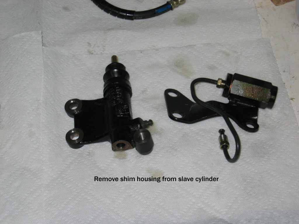

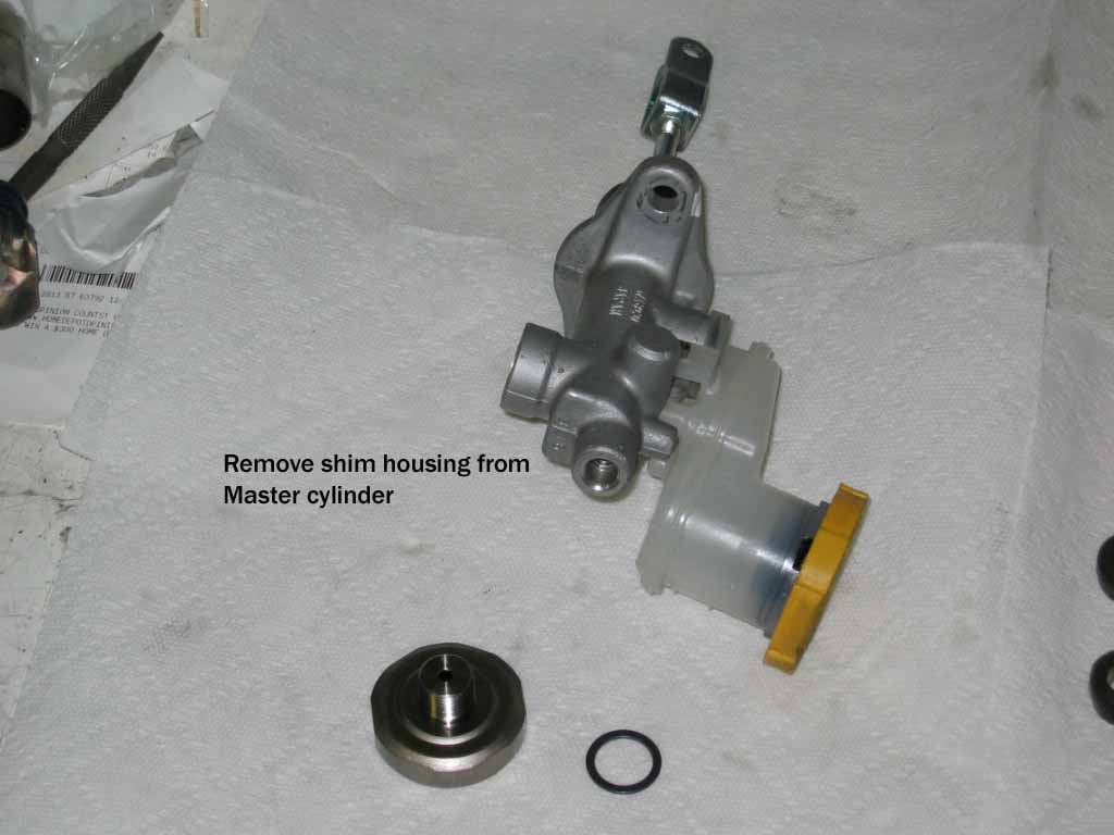

remove shim housing from Slave.

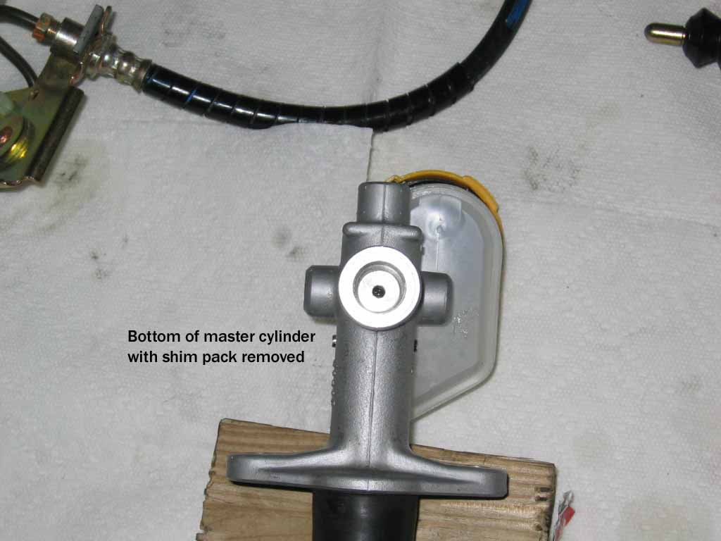

remove shim housing from Master.

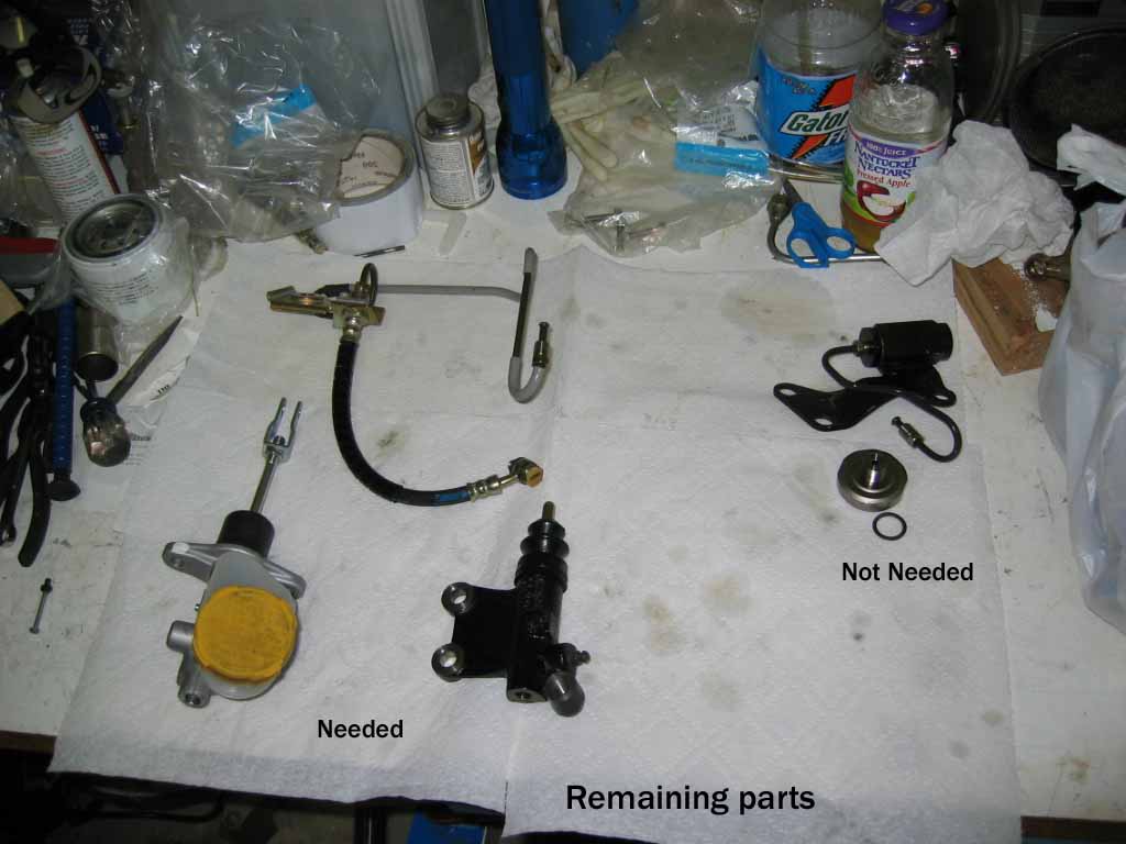

What remains.

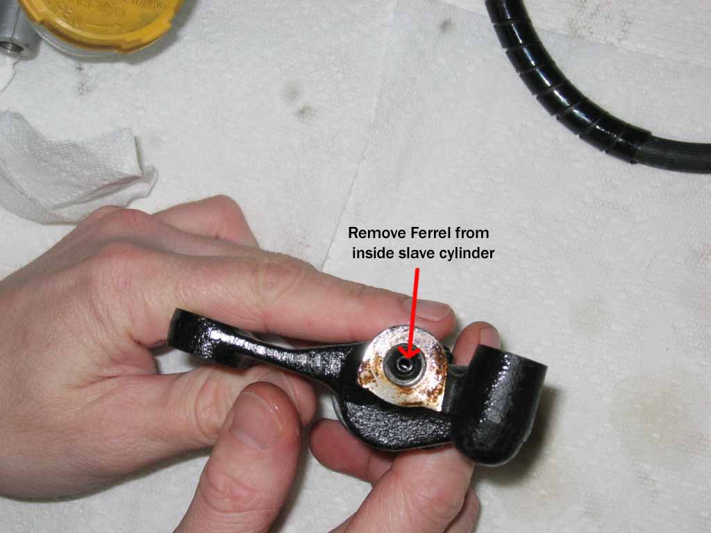

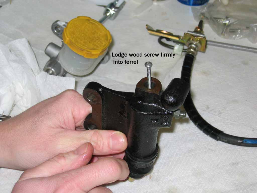

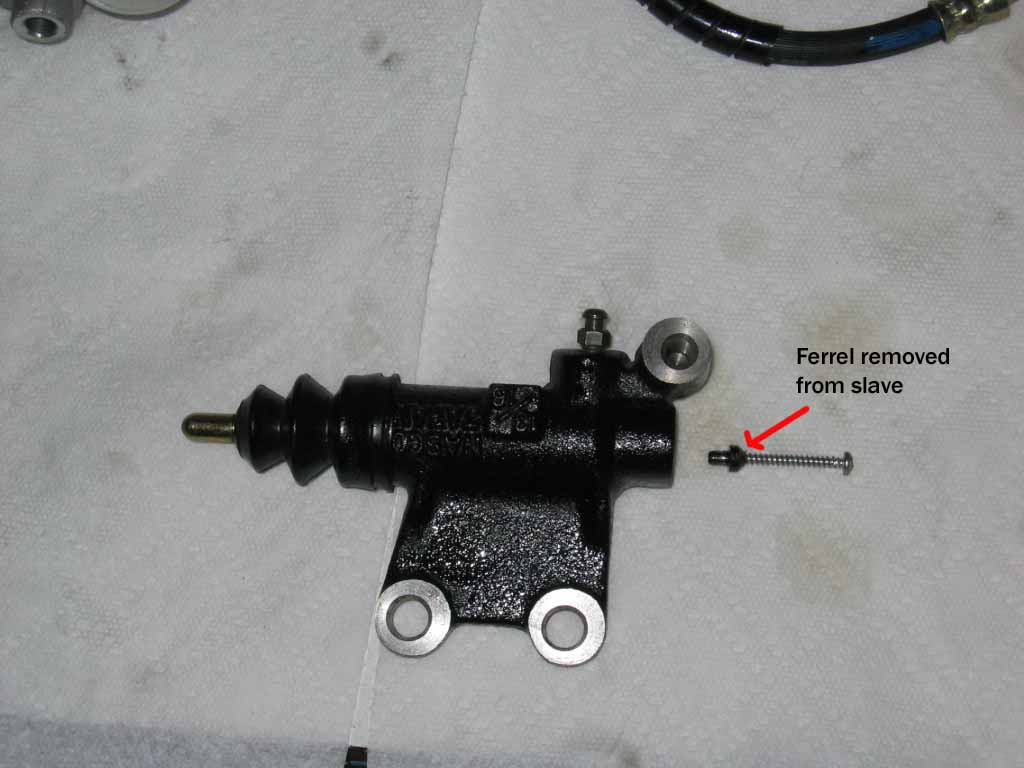

locate Fellel fitting inside Slave cylinder
Find an appropriate diameter wood screw to thread tightly into Ferrel
insert. Then with the Slave held firmly in a vise take the claw of one
hammer and hold the screw like you would to pull out a nail. With another
hammer hit the claw till the ferrel is removed. (note: not much force is
needed)

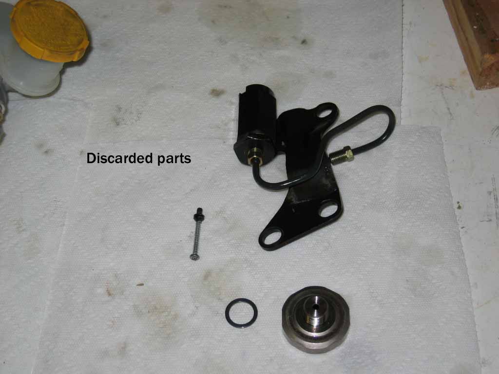

This is what you should have once the Ferrel is removed

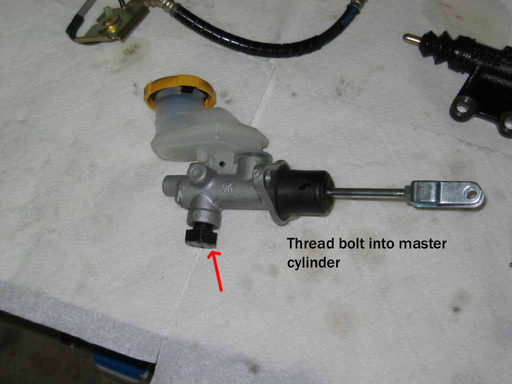

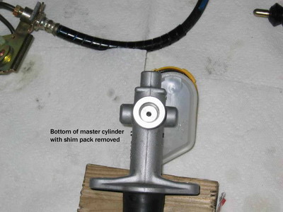

Next is the master cylinder.

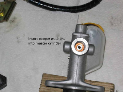

Parts needed to plug hole in master. (note: you must file the end of the
bolt to a flat surface to insure a good seal with copper washers)

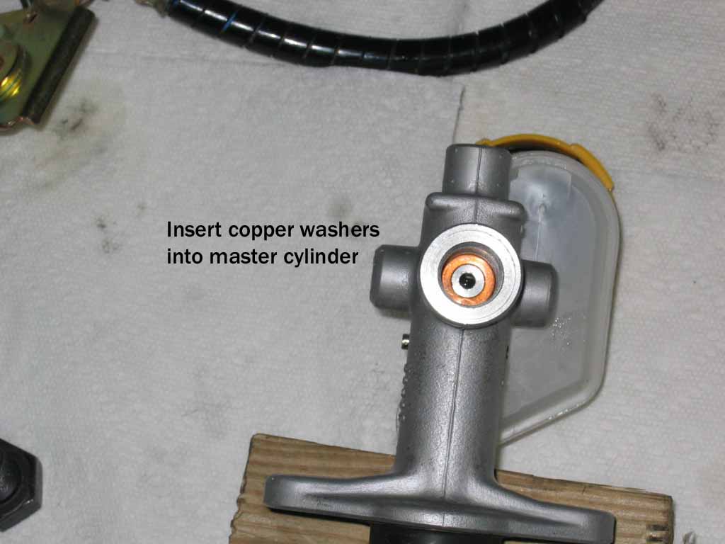

Insert washers as shown.
Thread bolt into Master Cylinder and tighten till it bottoms out on
washers. Then add 1/8 turn to compress washers.

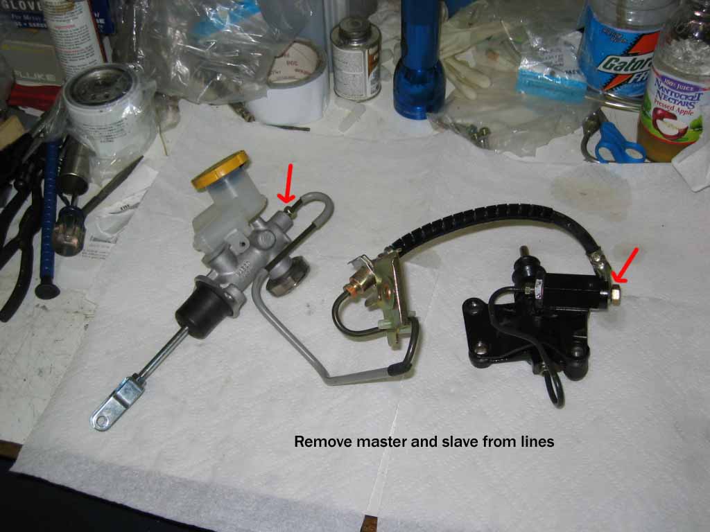

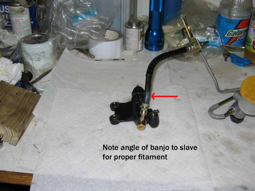

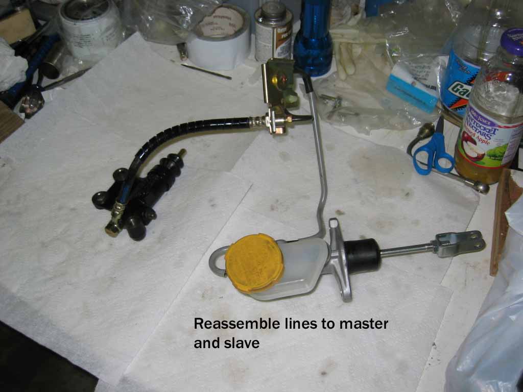

Reinstall lines to Master Cylinder and Slave Cylinder. (note: the bend in
the line must go towards the body of the Slave Cylinder.)
Please note angle of the line relative to the Slave Cylinder for proper
fitment. Now tighten all fittings (snug + 1/8 turn)
what's left
bench bleed system and reinstall in reverse order to 1-8 as listed above.
