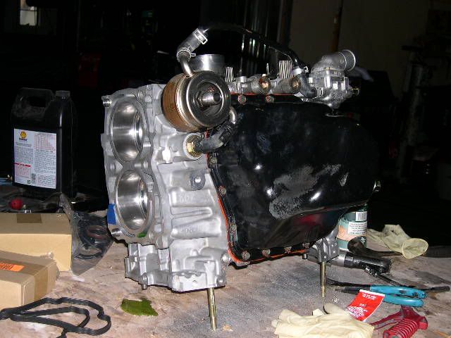

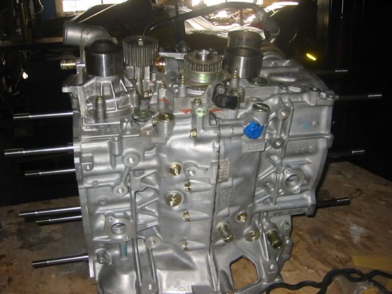

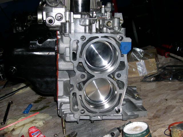

The first thing I needed was a bottom end to hold the amount of power I wanted, so I had Automaster order me an S3L block from Crawford Performance. In addition, I needed all the gaskets, APR head studs, PE kevlar timing belt, etc, which was also ordered.

I will be keeping a picture diary of all the mods and the progress as we move further into the project. Right now the Crawford block is at the shop, and I will be posting pictures as soon as I can upload them from my camera. As soon as the heads come in I will be posting pictures of those as well, along with any other miscellanious parts that come in.
I can't wait to see where this project goes!
Updated: Here are a few pictures:

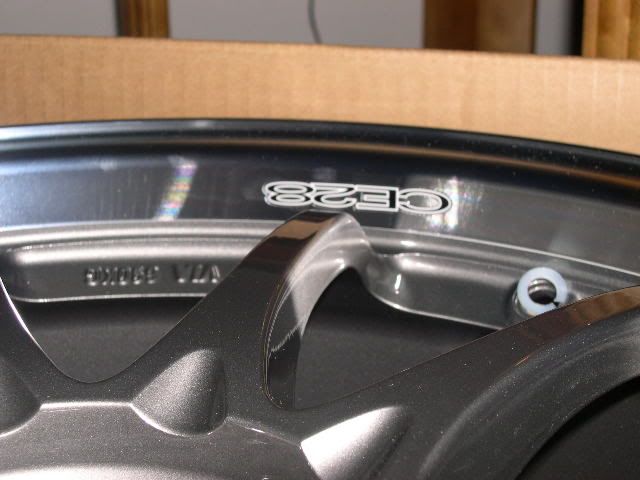

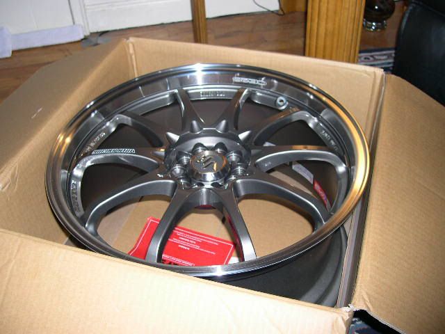

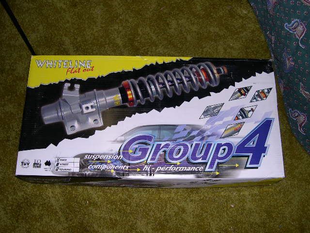

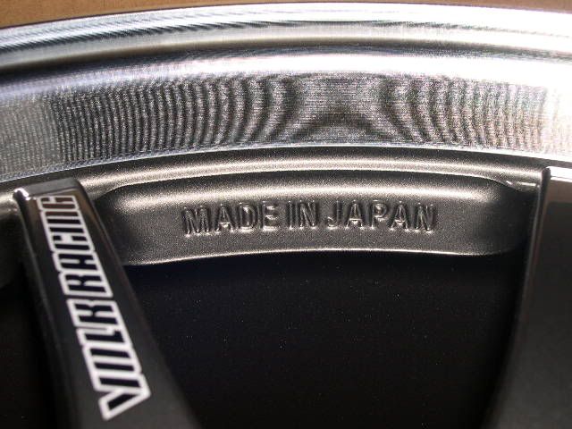

I also forgot to mention in the above post that I have the whiteline Group 4 coilovers installed on my ride...and new shoes for next summer.....Volk LE28N's
Here are a few picts:
