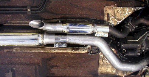

Here is the muffler, guys. The turndown is not attached and I don't think it is necessary. I got under there and lined things up, it looks like I will just have to cut the angle off of the dump tube and weld the muffler on. It seems like it will fit nicely next to the downpipe and only hang about a half inch lower than the DP itself. I will probably make some kind of exhaust hanger attached to the downpipe to make it stable.

Car goes to the fab shop Tuesday to get the rear fenders pulled and have this muffler welded in. Was going to do it myself, but I am not the greatest welder and would like it to be as clean and OEM-like as possible.

Here is a quick video from my phone with the windows down. The sound is really poor quality. In real life it sounds MUCH deeper. I will try with the GoPro this weekend and see if that sounds better. It is a much more desirable sound than the EWG without the muffler. It almost reminds me of the Subaru rumble which is interesting because I have the EL header. I would recommend this to anyone looking to make their EWG a bit quieter without completely getting rid of the sound or routing it back into the downpipe. No boost creep problems. The fabricator took some pictures of the setup, I will try to post them here later. Basically he extended the dump tube with a J bend and clamped the muffler onto the part of the dp that runs parallel to the ground.
