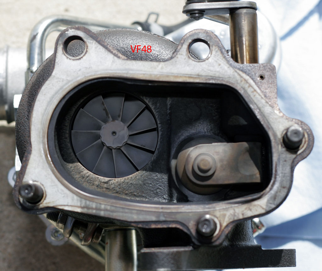

Another update to the original post. We are now up to 22psi and you can see the VF48 and 20G both hit 22psi at roughly the same point. The only difference is that the VF48 gives you a little bit more flow under 3500 and then starts losing it quickly. The 20G takes over and continues to hold boost towards redline. We believe on the IWG and stock boost solenoid it'll hold 19.5-20psi at redline.

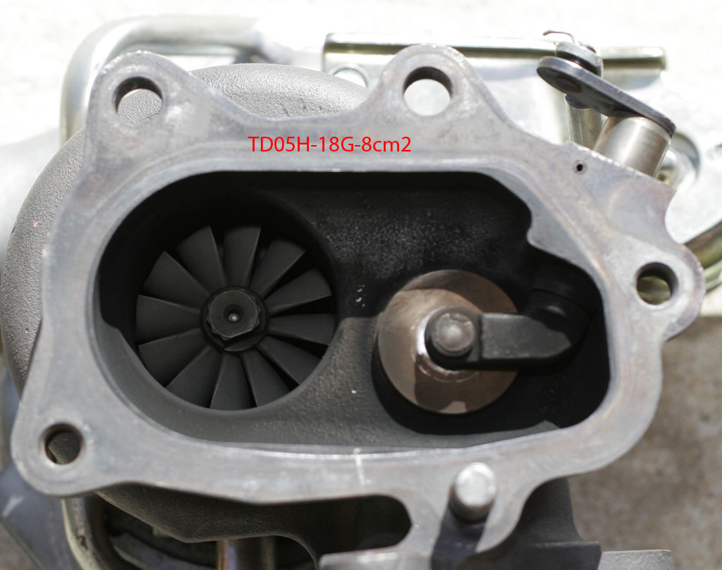

How was the install of the 18g? I just heard back from a friend who did the install last night on an '08 and apparently it was a nightmare getting it to fit properly; coolant line, ic hose, etc. I had pictured this install as a simple swap, but maybe not?
Discussion starter · #32 ·
Re: VF48 vs 18G vs 20G
We haven't put my 18G in yet, still waiting on parts from Perrin before I toss it in. The only time I've had trouble with a Blouch was with the Dom3 and an APS TMIC, there is VERY little clearance between the turbo to TMIC elbow on that thing. I've also purchased an aftermarket 90 degree elbow for the turbo to TMIC as they don't fit the factory hose 85% of the time.
On the 20G we were able to re-use the factory hose but it was a tight fit.

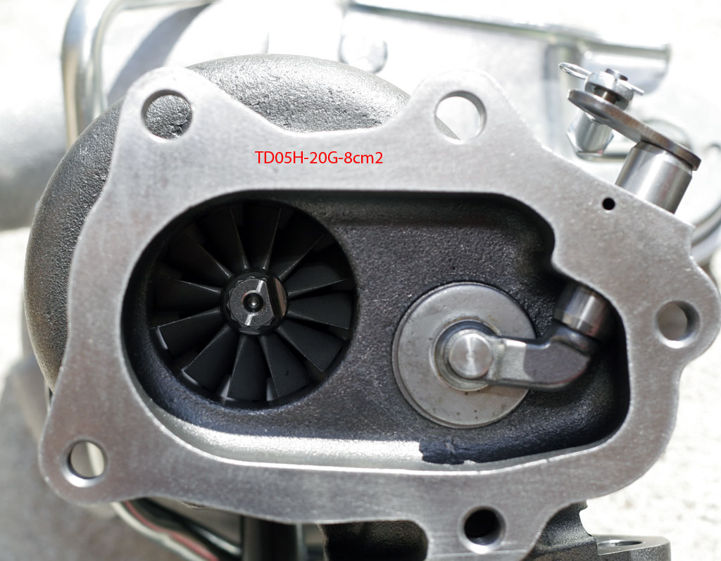

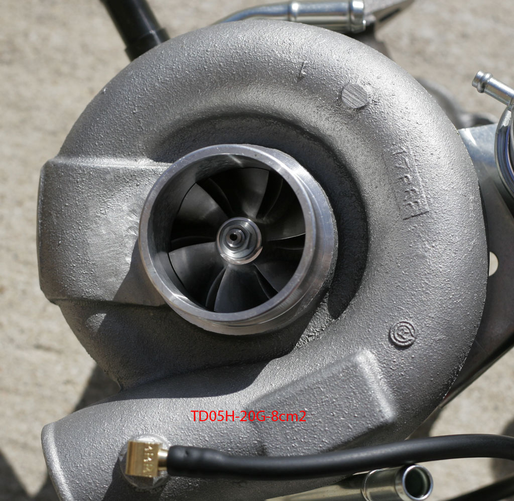

would a TD06 20G 8cm have less boost taper than the TD05? can a 20G hold max boost to redline?
The TD06 would have slower spool but slightly better boost retention. What's your definition of max boost? We are holding 20-21psi at redline without the EWG right now.
Would a TD06-20g w/7cm housing have any better top end?
Or pretty much the same, with more chance for creep?
Is creep with a 7cm really a concern with a catted turbo back?
Discussion starter · #40 ·
7cm will be more prone to creep, but loses your top end airflow. If you don't care about early spool and want mid-top power a TD06-20G-8cm2 would be the best. If you want good spool and pretty good mid-top the TD05H-20G-8cm2 is the best combo. You get the best of both worlds.
