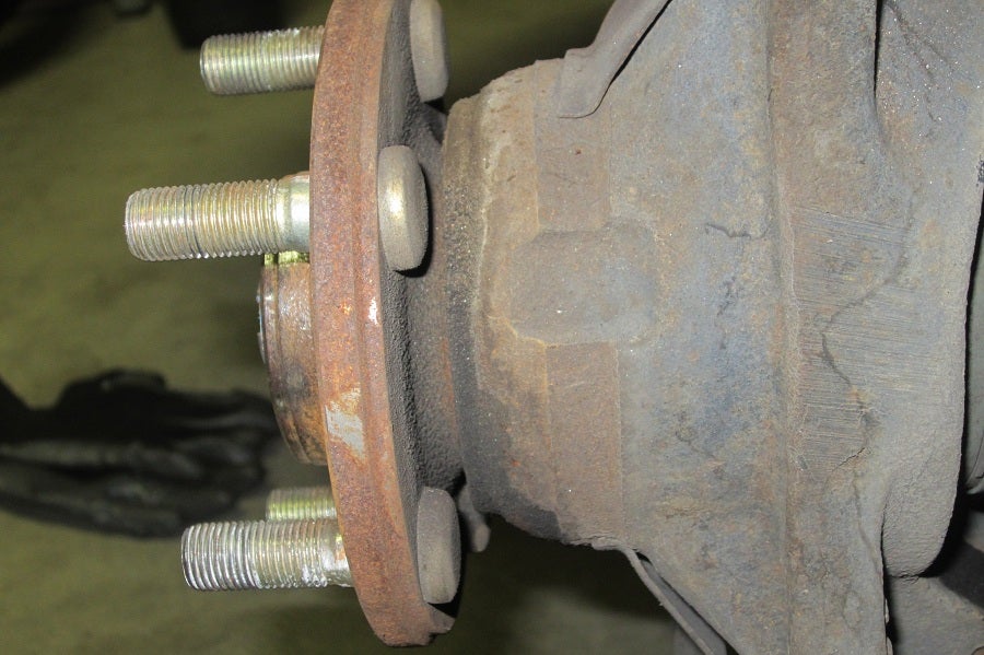

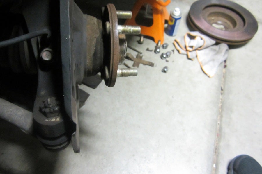

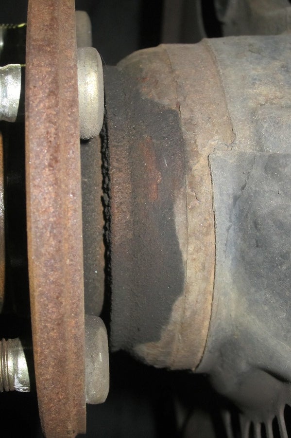

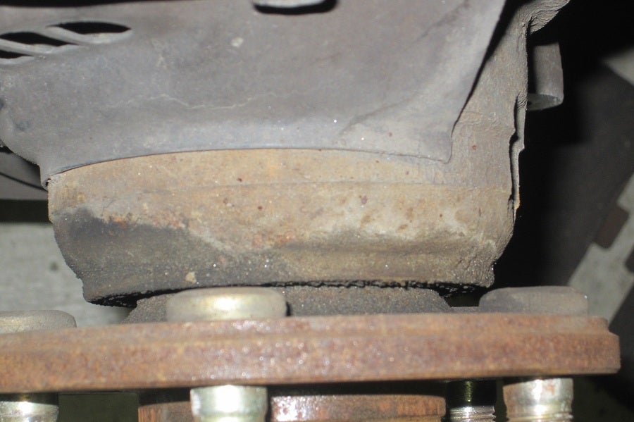

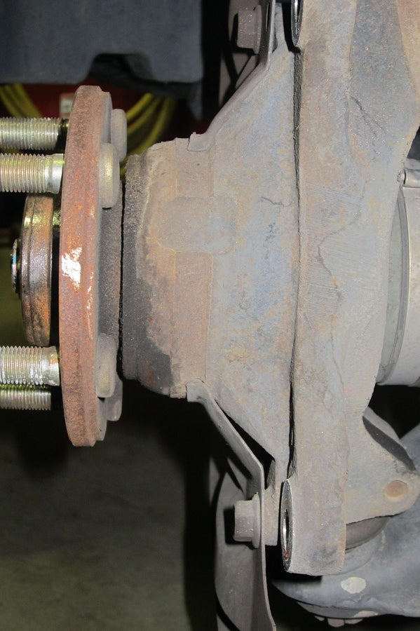

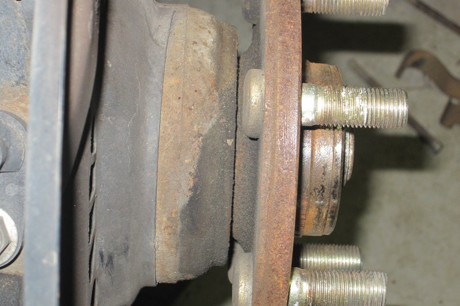

I just replaced my front driver side with a Koyo bearing, it's an OEM replacement bearing. Before it was pressed in I cleaned out the bearing grease that came with it and repacked it with better grease made by Valvoline/ European-Japanese imports. So far no problems. I'm planning on replacing the driver side this weekend as it has the classic symptoms of the "whom, whom, whom" sound at low speeds(around 20-25 mph). I got both bearings at NAPA auto for $98 w/ military discount and went with OEM for inner and outer seals. Here's what I found on the driver side. The last pic was taken from the bottom of the knuckle. I've never seen wheel bearing grease leak out like that before. So glad I'm doing this as this could have been more $$$.
