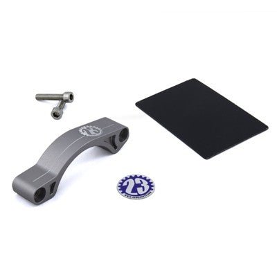

The timing kit is pretty nice too. I like how it comes with the timing belt guide since the IAG kevlar belt is HUGE. Compared to my OEM timing belt, the IAG belt seems super thick visually. Its also super strong and made it a bit of a challenge trying to line it all up on the teeth of the crank sprocket and tooth idler. It took a couple of attempts to get it right and definitely wasn't having the "just lay it in there" approach. We ended up using the red gapping tool that comes with the gates timing kits in order to adjust clearance on the IAG timing belt guide. Due to the kelvar belt being so thick, we also had to adjust all 4 of those small belt guides on the corners of the inner timing covers. Im not exactly sure what those things are called but good thing we checked them. A feeler gauge, a mirror, and some patience is all I have to say.
