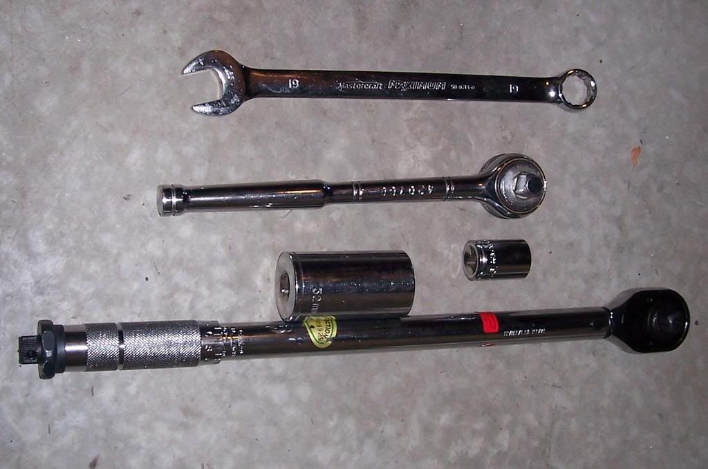

Heres a quick "cheater" way to change your rear axle.
Heres the tools you'll need to do the job
1/2 torgue wrench (good for 145lbs)
32mm socket
1/2 drive ratchet
19mm socket
19mm wrench
not shown:
and a plastic hammer
jack and safety stands
wheel wrench
32mm socket
1/2 drive ratchet
19mm socket
19mm wrench
not shown:
wheel wrench
