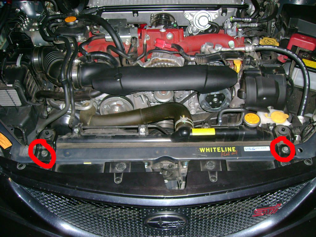

3.) Remove the two upper radiator brackets by removing the two 12mm bolts circled in red. Not shown, but loosen the two clamps at the ends of the airbox's accordion duct. No need to remove them or the duct:

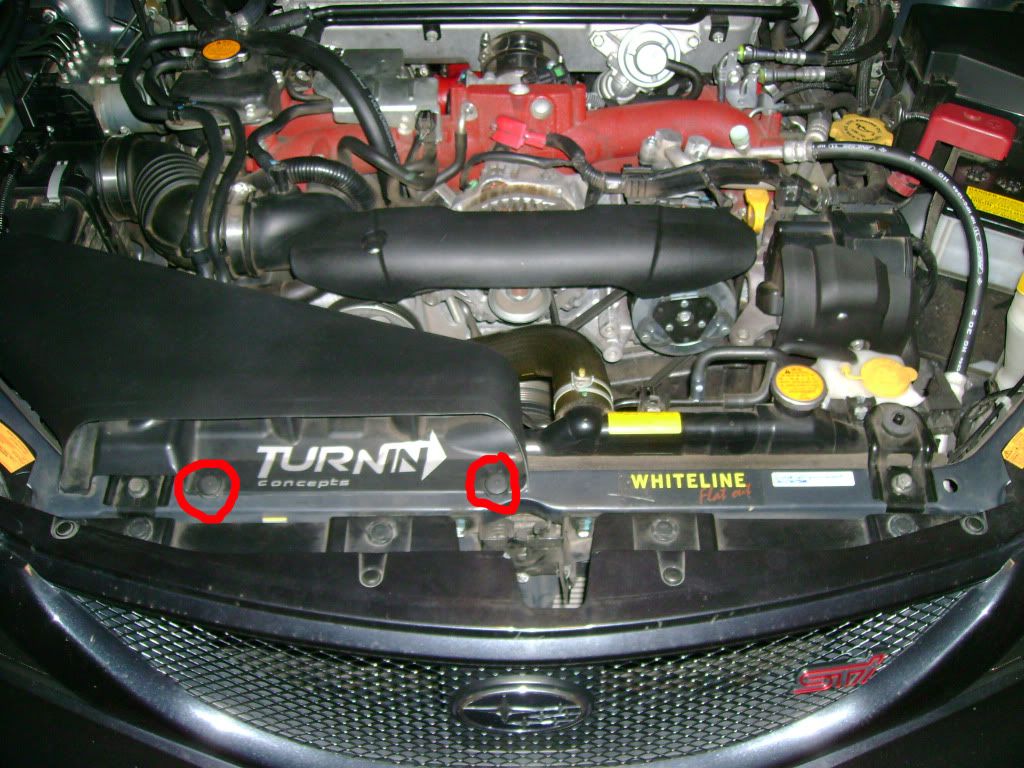

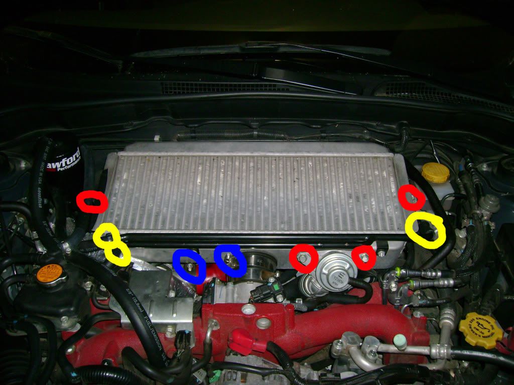

4.) Remove the intercooler. Accomplish this by removing the two 12mm bolts holding the BPV as well as the two 12mm mounting bolts at the ends (all four circled in red. Loosen the two clamps circled in blue (can be done with a phillips or 10mm socket, I believe). Finally, remove the three breather lines from the breather tube (circled in yellow). Just pull and they slip off. Finally, remove the IC by pushing towards the firewall until the TB connection is out, then pull towards the drive side to pull it off the turbo. Be careful of the fins, and set it aside:

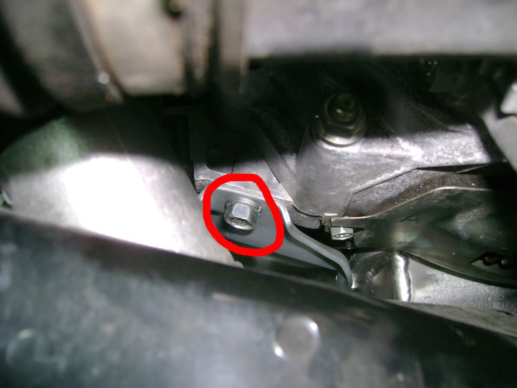

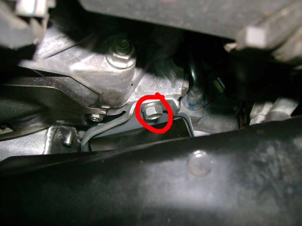

5.) Unbolt the lower pitch stop bolt. Now that the IC is out of the way, access is easy and it is circled in red. Use a 14mm wrench on the nut with a 14mm socket and breaker bar on the bolt head. Once loose, remove the bolt and tilt the pitch stopper up as far as it can go:

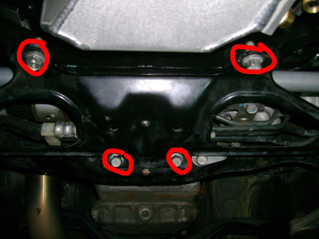

7.) Remove the subframe lower brace as seen here. Ten total bolts, all 14mm (two have 14mm nuts) and you may need your impact/breaker bar. There are four center bolts as circled below (note that the forward two have a nut instead of threads into the subframe):

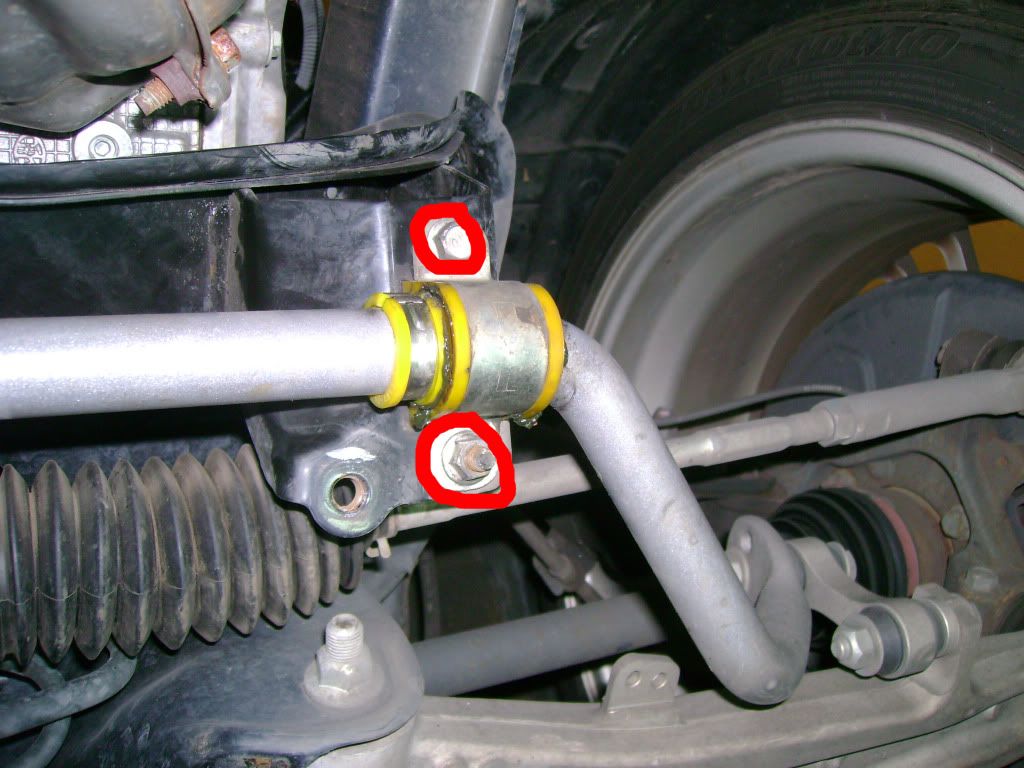

8.) Remove front swaybar D-brackets by removing 12mm bolts and 12mm nuts (one each per side, shown below on driver side):
Then swing the entire swaybar down:

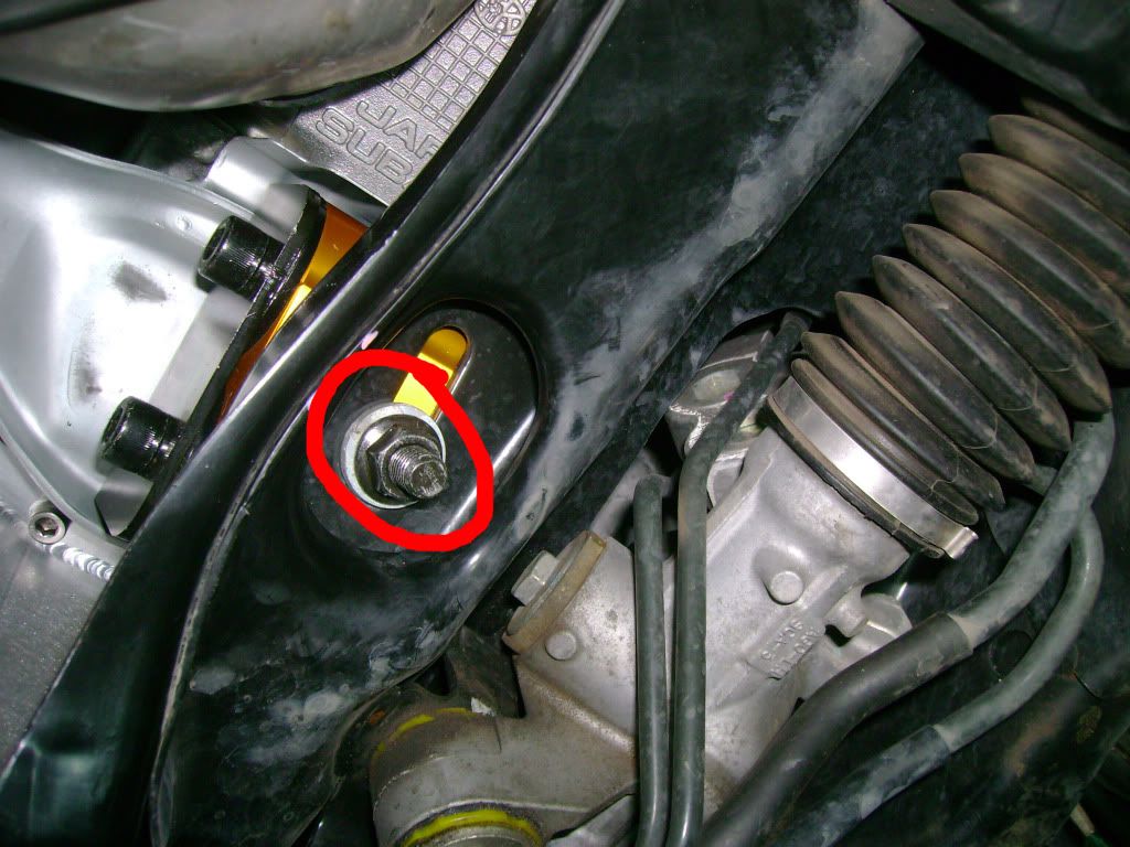

9.) Using your impact or breaker bar and the 14mm deep socket, remove the two 14mm nuts from the bottom of the engine mounts, circled in red:

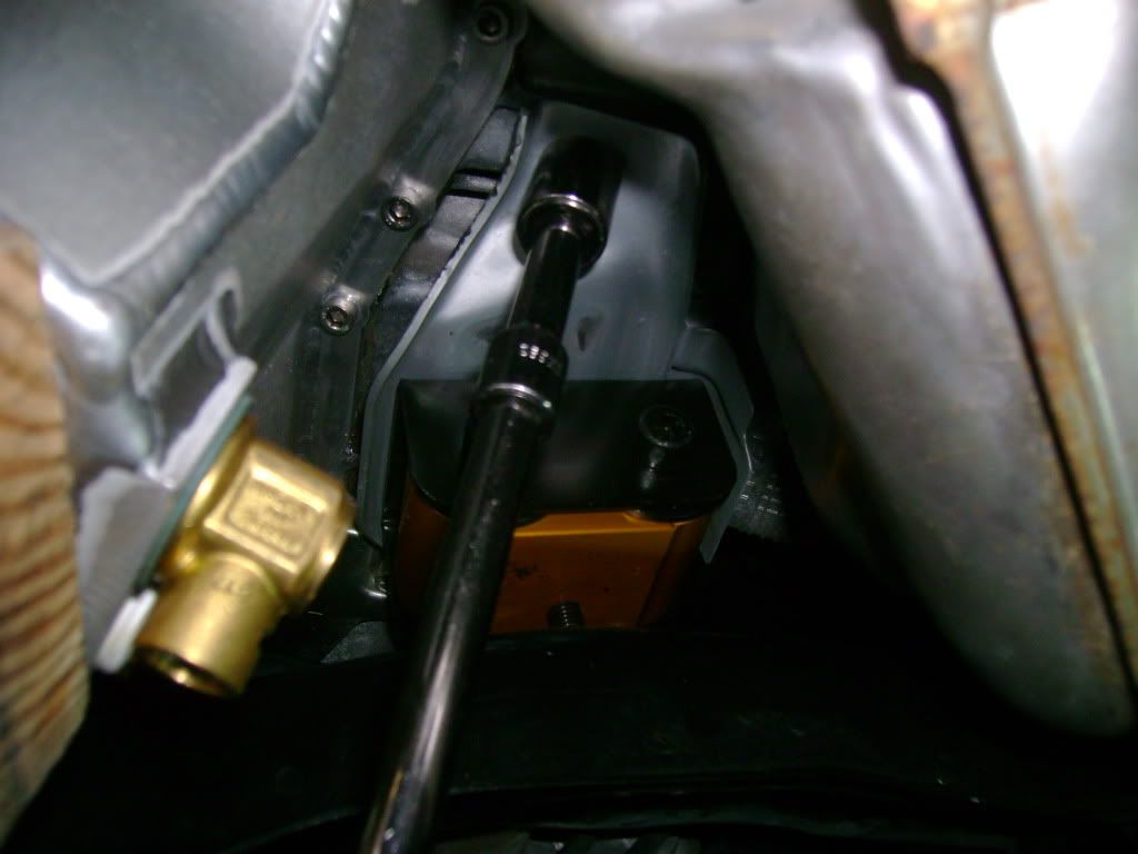

11.) Pick a side to start on. With the engine high enough, use your breaker bar to take out the forward 14mm bolt holding the mount bracket to the engine:
12.) Now, do the same for the rear. Here you will have to use the 14mm flex head ratcheting wrench. This single tool makes this job easy. If you need extra torque to break it free, put another solid box end wrench on the open end to give you more leverage. Once it is removed you can now remove the bracket and mount together. Below are pictures of the rear bolts to help you find them. I can tell you the driver side is the harder since the steering column and rack are more in the way.
