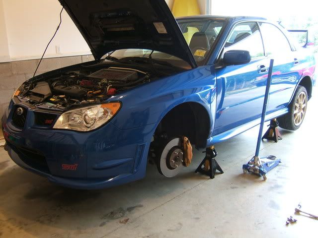

Please note that having the car put up on jack stands and removing the wheels is optional. You can perform the whole coolant change from the top of the engine bay by removing the OEM air intake which gives you access to the drain plug underneath. The front undercover is also removable without putting the car up on jack stands. You'll need a low-profile drain container which is available at most supermarkets and auto shops. Optional steps are shown in the drain procedure section.
1. Park on a level surface and turn off the engine.
2. Secure the car from rolling by engaging the parking brake and putting the car in reverse after the engine is turned off. Use wheel chocks as necessary.
3. Loosen the front wheel lugnuts on the passenger side just enough that you can remove this wheel once the car is lifted up. I loosened them on the driver's side as well for the photo, but this is not necessary.
4. Put the car up level on all 4 jack stands. Reference the following link carefully as I do not condone all of the methods proposed here for securing the car: http://www.iwsti.com/forums/how-ins...ow-install/85671-how-complete-idiot-s-guide-getting-your-car-up-jackstands.html. The car should be placed on jack stands at the reinforced pinch welds whenever possible. It will not hurt to put additional support under the car in the unlikely event that the car's weight should shift or a jack stand or support member should fail. Whenever possible, do not place your body directly under the car when it is elevated on jack stands. It's also a good idea to have someone else nearby when working under a vehicle.
5. Remove the front wheel on the passenger side. Again, this is optional. I also removed the driver's side wheel for the photo, but this is not necessary.
6. Pop the engine hood and allow the engine to cool for at least an hour.

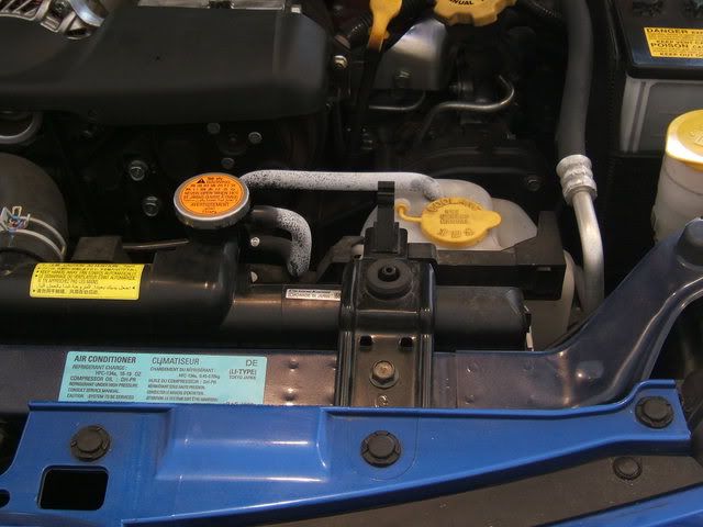

System Overview:
The "Drain Plug" sits at the bottom of the radiator on the passenger side. It sits directly over the subframe and is identified by its wingnut shape.
The "Filler Tank" is a small black plastic tank located over the engine between the air intake filter and the intercooler. It has a tabbed radiator cap. The Filler Tank is the highest point of the system.
The "Filler Neck" refers to the top portion of the Filler Tank just below the cap.
The "Radiator" is a large rectangular tank that sits vertically across the front of your engine bay. It has a round radiator cap. You do not need to remove the round cap at all during this process. However, it is an optional shortcut when you first fill the system during the filling procedure.
The "Reservoir Tank" is a white plastic tank that sits just to the right of the Radiator. It has a yellow plastic cap that reads "Coolant". For the 2007 STI, the part number is 45150FE000. The description is Tank Assy Reserve. This part includes the small coolant hose that runs from the radiator to the reservoir tank. The cost is approximately $52.44. I needed to replace mine due to a small leak at the base of the tank. The small coolant hose was also leaking due to a small tear in the hose.

5. Open the *tabbed* radiator cap on the Filler Tank. It is located just above the engine. Removing this cap will help the coolant drain more quickly once the drain plug is loosened. Check that the cap has a rubber gasket under the cap lip and near the tip.

You can do it with the wheels in place, but it helps a lot with access to have at least the passenger side front wheel removed. I went ahead and removed both for easier access with the Undercover as well. The drain plug doesn't turn very easily sometimes so it helps to have room to move around and see what you are doing. If I had a lift like a dealership or mechanic shop, I wouldn't bother with the wheels.
If you try it, let me know how it works out.
