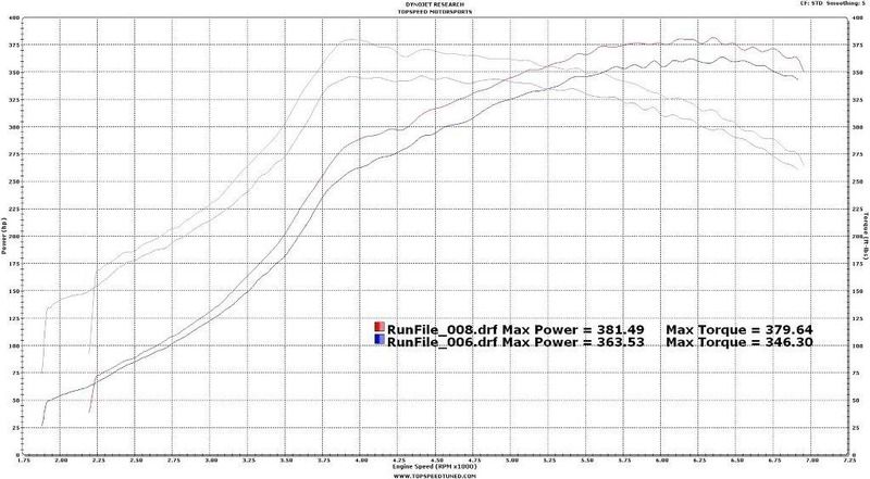

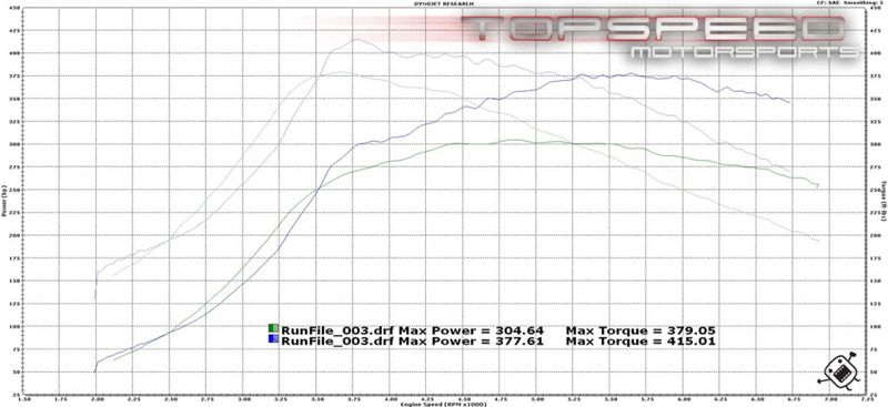

I've got dyno curves in my journal (2nd post) of my 2.5xtr with e85 and 93, running a PnP header. Hopefully in the next two weeks I will have a plot for the 2.5xtr with the holy header and EWG with both fuels as well.
I have heard the 2.5xtr with the 8cm hotside responds nearly the same as the 1.5xtr with more holding power...i have the 10cm hotside which supports better holding in the upper revs but am still at full boost at ~3500 RPM( I picked up about 300 RPM with the PnP header)...food for thought. I can say once it starts to come into boost it hits like a freight train and doesn't stop.

Just saw those plots in your journal and that is indeed a much quicker spool than I anticipated in regards to the 2.5xtr. Your numbers appear a little low though, Im sure the Killer B will fix that :)

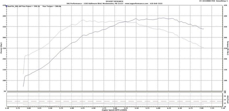

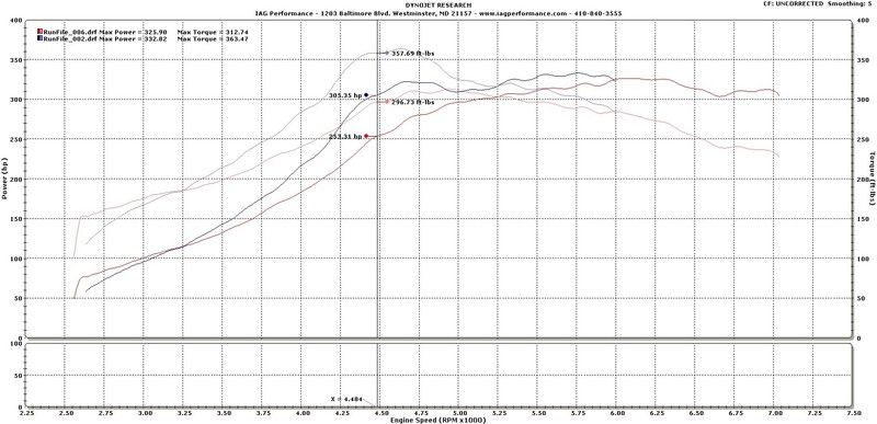

That Tq Tho... :D This was also a messed up run becuause this places dyno bay was terrible and had zero air flow. My IATs on this run started in the 135s and ran up to 180s... and get a load of the ambient outside for that day... :/
I don't like going by numbers anymore though because every dyno is different. You will never get the same. What you can do though is get an overall increase given a stock STi base run. When I do that - it normalizes all of my dyno runs (I have been on 4 different dynos and all were different!).
Overall my 1.5 XTR set up put me @ a 60% increase in power over stock on 93 and and 80% increase on E85 - and thats with a conservative safe tune as its my DD. Over 35K miles on my set up so far an zero issues.

Only reason for low numbers was to not stress the stock motor. Mikey said that with pump and E85 I had a lot more to go but once you go above 350 it starts to challenge the stock block, which isn't currently necessary.
We did one run during tuning the was right around 400 but dialed it back down.

Looked at your plots again and wow, your Dom 2.5 seems to spool almost like the stock VF! I swear the other Dom 2.5 plots I saw on EFI's website didn't spool that quickly. It almost looks like a Dom 1.5 boost plot.
