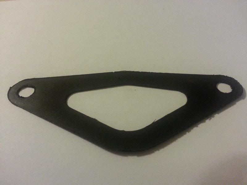

here is the bov to tmic gasket. i just recently installed the downpipe yesterday. i double checked every bolt (because it wasnt very roomy and didnt want to un bolt everything again lol) and replaced the turbo to dp gasket and dp to exhaust gasket.

What's with the gasket pic? Did you not put that back on?! That NEEDS to be ON THERE!

Yea the gasket was on. I was just wondering if its still good. Thats the only gasket I didnt replace. I emailed cobb but have to wait 4-5 days to get it looked at by a tech. Thanks for all the help though. I plan on driving to cobb plano for a custom tune on friday but I wanted to make sure everything is running good

Yeah that gasket looks ok. The edges of it don't matter. the main sealing surfaces are really what matters.
