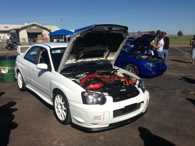

Import Face Off
Decided to go to Import Face Off with a few buddies in Topeka, Kansas. One of my buddies was entering the show (blue bugeye), and figured I'd try it out since I have never entered one (not really my kind of thing). But we had a good time and didnt have to worry about idiots in the parking lot door dinging my car :lol:
One of the first people there.
I dig white on white!

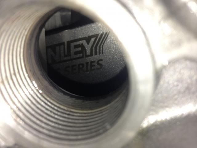

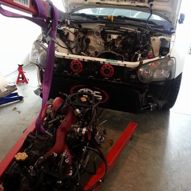

Time for a stronger block and more power!
-Subaru OEM Shortblock Halves (Assembled by RevWorks)
-Subaru OEM Crank
-Wiseco 99.5mm Pistons
-Manley H-Tuff Rods
-ACL Race Rod Bearings 52mm Journal
-ACL Race Main Bearing Set Standard
-Subaru 11mm Oil Pump
-Subaru OEM Engine Gasket Kit Set
-ARP Headstuds
-Machine Shop Cylinder Hone
-Moroso Oil Pickup
-Grimmspeed EBCS
-AEM UEGO to replace my TurboXS wideband

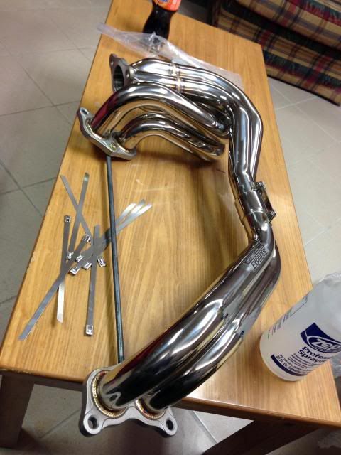

-Tomei UEL Header
-ATI Gauge Pod
-Gates AC Belt
-Gates Alternator Belt
-Gates Powersteering Belt
-Gates Racing Timing Belt
-Subaru OEM Magentic Oil Drain Plug
-Subaru OEM Crank Bolt
-ACT XTSS Clutch
-Subaru OEM Flywheel

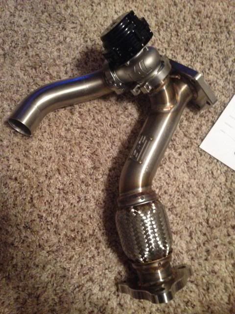

-Grimmspeed 3-bolt EWG
-Tial 38mm Wastegate
-Crawford AOS FMIC
-Grimmspeed Lightweight Crank Pulley
-NGK LFR7AIX Spark Plugs
-Subaru Blue Coolant and Conditioner
-Perrin Fuel Rails
18
I was debating on the H-tuff as they were beefier and I could get them for less than a retail set of regular H-beams, but I figured for 400-430whp, stock 08+ rods would do. I took the lazy way out.
