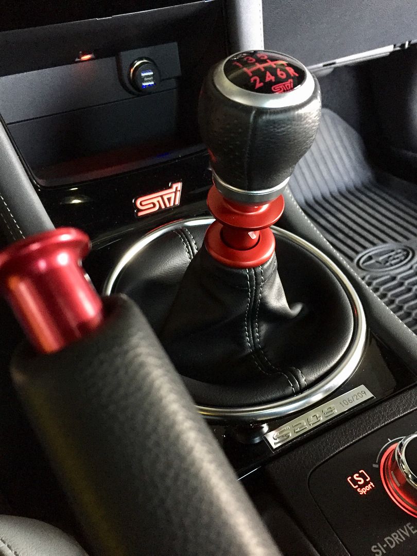

Installed today...Raceseng Reverse Gear Lock-Out Lever
Shift knob out:
Shifter boot out:
Remove two Phillips screw under the stock lock-out base:
Shift to 3rd gear, then punch out the lock-out lever roll-pin retainer:
Insert the Raceseng lock-out base, secure with two Allen bolts provided:
Grease the lever travel section and insert the lock-out lever and secure with the flat-head Allen bolt retainer:
Re-install shifter boot:
Re-install shift knob and test the new reverse gear lever function by shifting to reverse:
