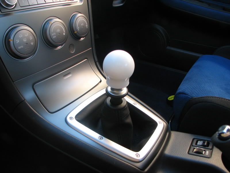

It's actually very comfortable and does not get so hot in the sun. It the new Totsubo knob(also in black)FYI.

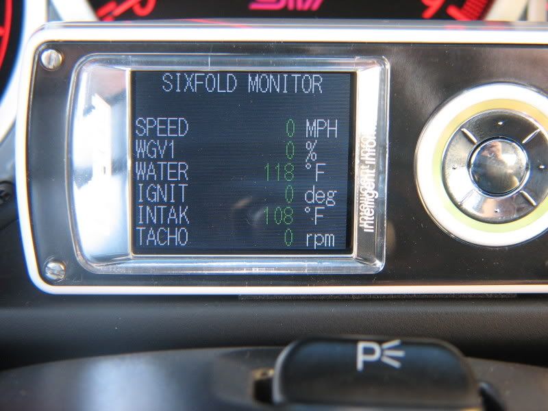

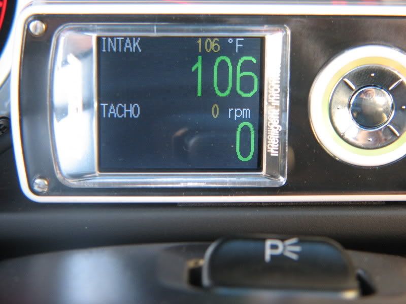

Also installed the Informeter. It just plugs into the OBD and you mount it where you want to. Then you can monitor things like water temp, boost, A/F ratio, injectors, Waste gate duty, RPM, speed, Intake temp, timing, Etc...You can change colors, and how many parameters you wnat to monitor(up to 6) at a time. You can also select sytle of gauge/monitor such as bar graph, numerical or dial.

But, does it use teh subaru specific com protocol to get full speed and all the functions?
And there is no delay in reading information.

how heavy is the shift knob compared to the stock one?
It's actually much lighter than stock, which is fine with me. I dont buy in to the weight helping your shift's thing, especialy with the Cobb SS. Plus is very comfortable in your hand and it does not get so hot in the sun.

^^^NO. It gets its power from the OBD. The adapter is for other makes and models.

Does it read oil pressure and temperature? ....I ask because I'm not sure if the OEM ECU reads those or not.
Where is the intake temp sensor located on the car? This little device might be worth it for that and the timing readings alone.

The ECU doesn't read oil pressure and temperature (and there are no sensors for that information on the car). The car does have a oil pressure SWITCH. But, that is it.

I don't believe it gets power from the OBD II plug but from a cig lighter (12v) source.
It works, at least on my 06. Another IWSTI member informed me that if you use the cig lighter to power the unit, when the intercooler sprayer in press the unit locks/freezes up. Just leave the 12v adapter in the freakin box, connect the orange quick connectors and mount it. How do you think the AccessPort get power? Oh ya, the OBD port.:lol:
