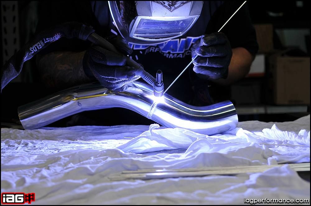

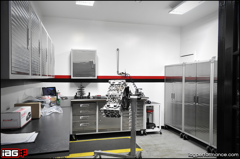

Credits to Boris at IAG for these spectacular images!
fuckin surgical welds

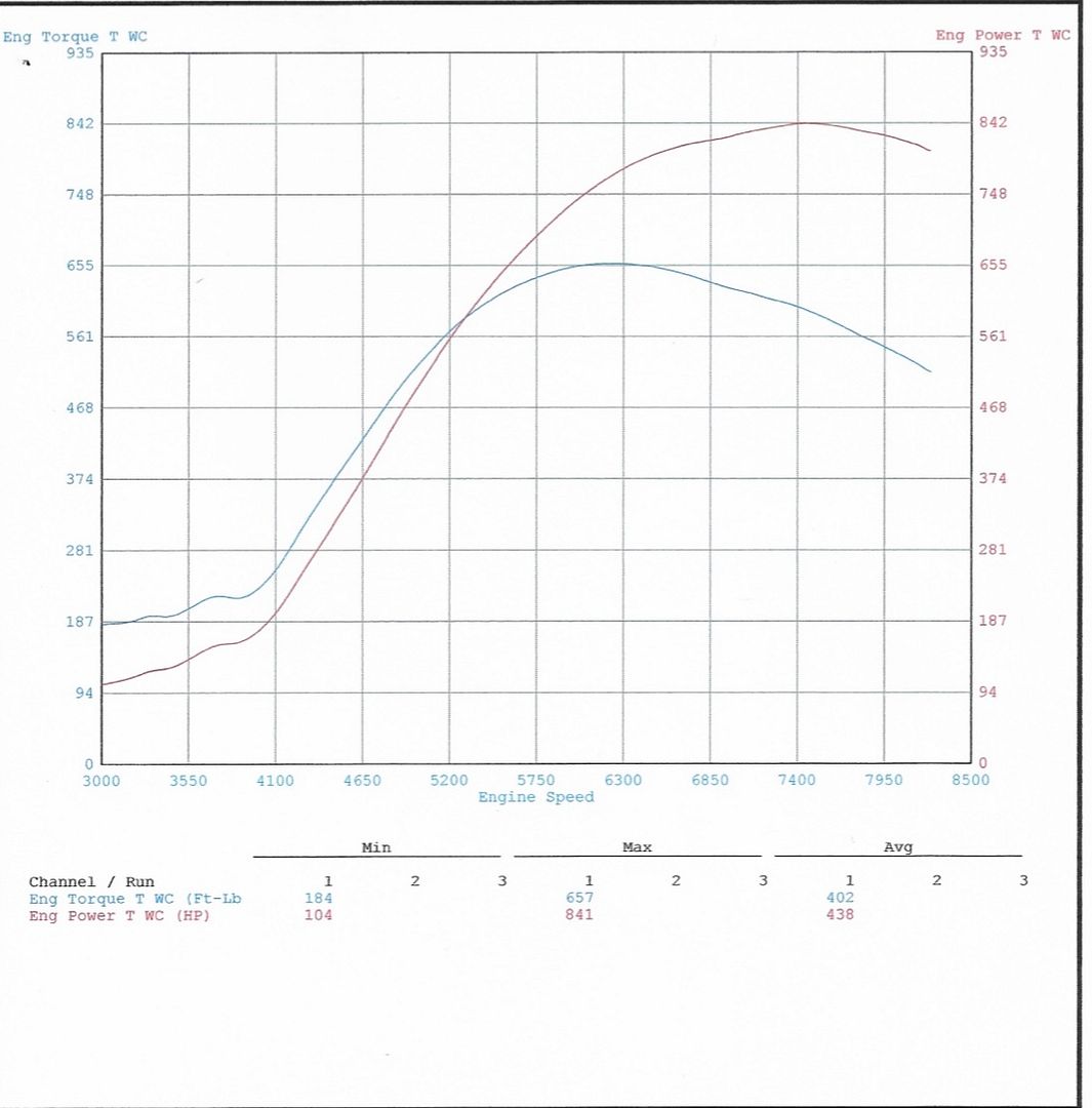

Ran the IAG Stage 4 Extreme closed deck for 45,000 miles (115,000 miles to 160,000 miles) at ~660whp at 39psi until a GSC valvespring suddenly broke and caused a bent valve. GSC refused to respond to any of my emails and questions
Lesson? DON'T BUY GSC BEEHIVE VALVESPRINGS

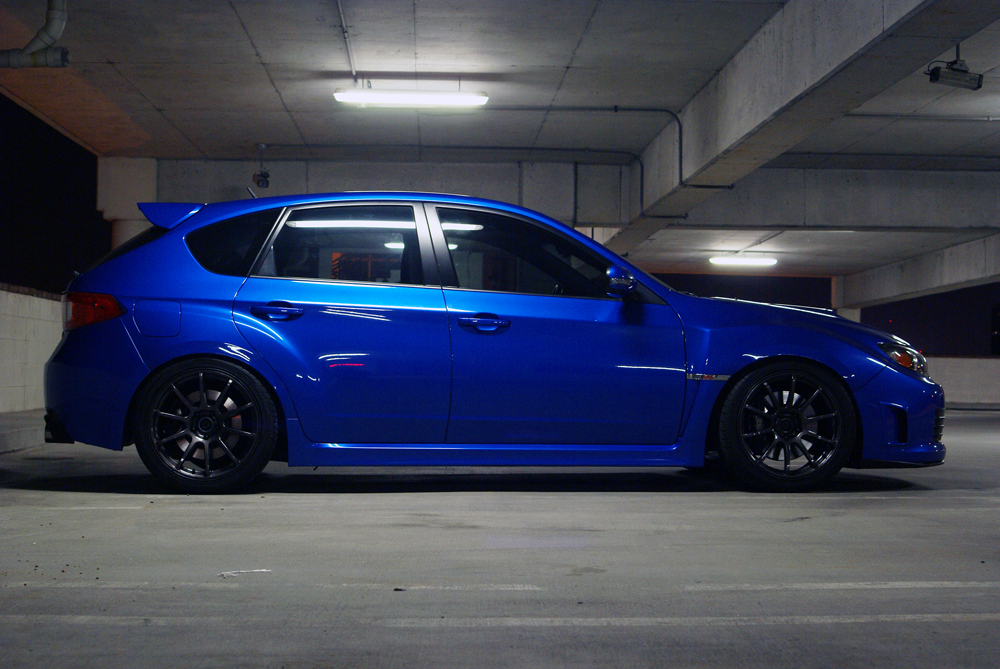

You my friend SLAMMED that thing! It looks great!

Form over function :lol::tup:
