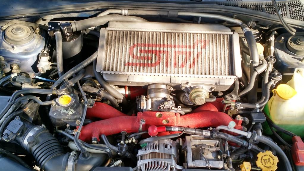

Personally, this is what my throttle body looks like with 30psi of boost and 3000miles with the IAG AOS (dat pink meth). No smell of oil at all :tup:
so stealthy that the dealership will think it is the 2015 STi sound tube :lol:

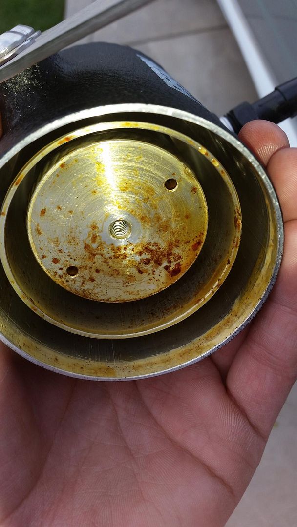

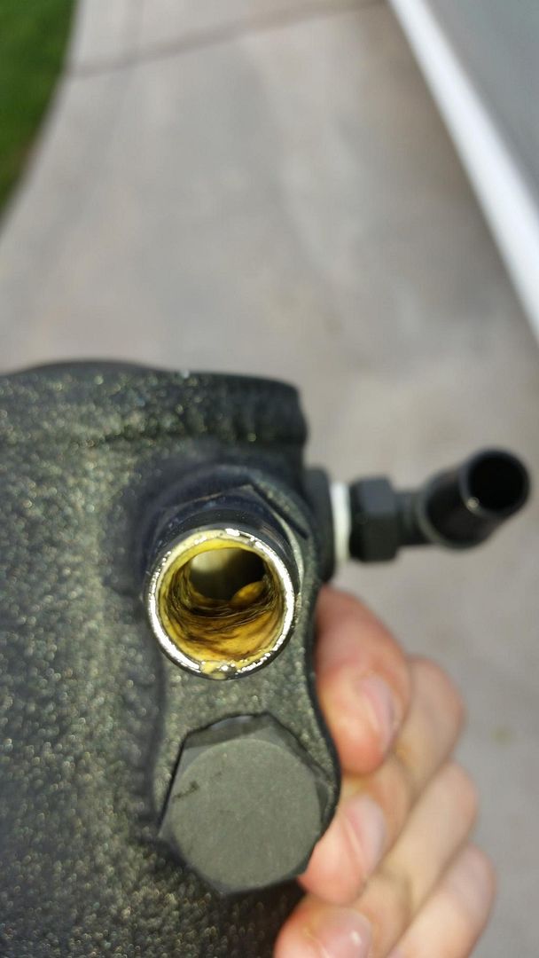

I bought and installed an IAG AOS 6 months ago or so and can attest to its usefulness. Hard to say that it is completely preventative, but I went from a little oil in the IC to zero and when taking apart the AOS, there is a film of oil inside. Definitely happier to see it there over being slurped back up into the engine.

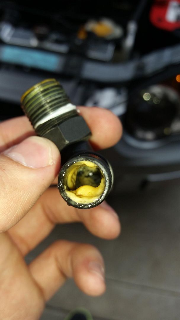

How is it doing in the cold? Lines gumming up at all?
