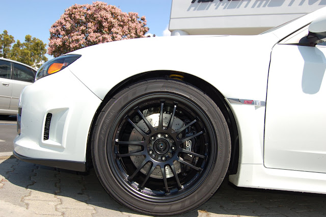

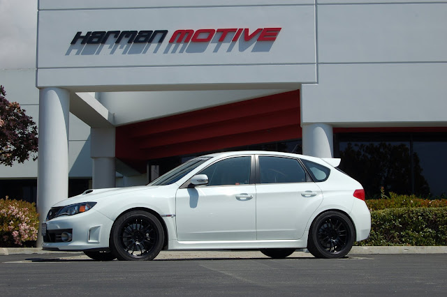

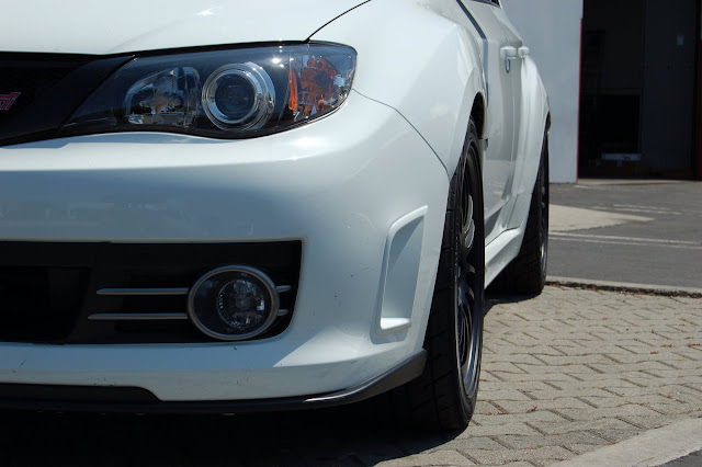

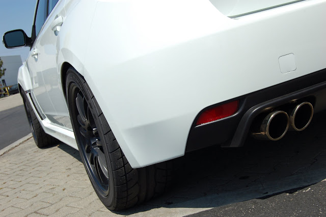

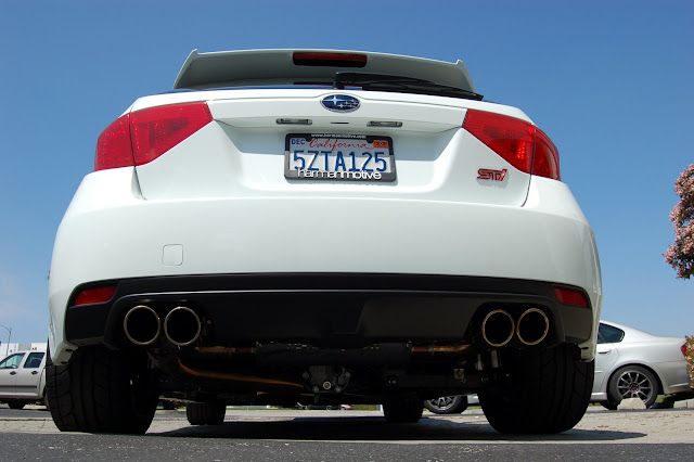

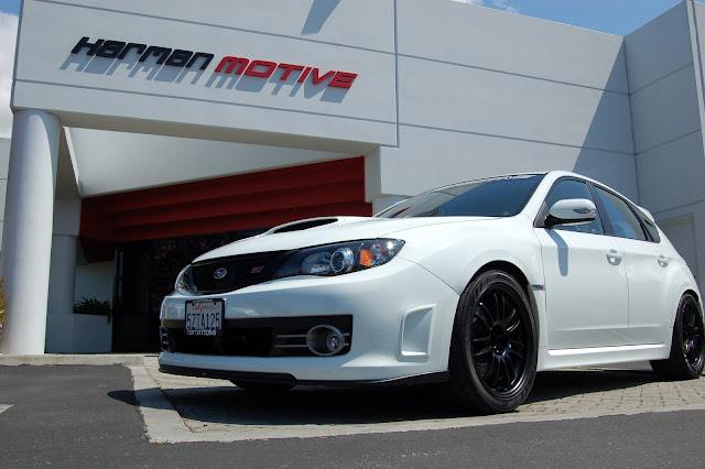

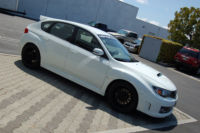

Here is the car as it sits today.
Harman Motive Catted Downpipe
Harman Motive Catback Exhaust
Protuned Accessport
KW Clubsport Coilovers
Volk RE30 18 x 9 et 35
Yokohama Advan Neova 255/40/18
Performance Friction Rotors
Ferodo DS2500 Pads
Harman Motive Brake Lines
Harman Motive Tail-light Overlay (Red)

that is a pretty good fitment.
did you roll the rear fenders at all?

Roll is putting it mildly :)
We had to roll the crap out of the front and rear to get this setup to fit w/o rubbing. Honestly the offset is too agressive and the ratio on the tires is a little tall, but it looks really nice.
Since we have already maxed out the fenders, in the future we'll be able to get some much wider wheels and tires in here with the proper offset.
- Dan

I thought as much.
keep us posted when you decide to put on some Proper fitment :)

man.. looks like you guys kind of jacked the lines of the fenders in your "rolling" process...
272 Posts
i agree, the car looks great otherthan the rolled fenders, the rear actually looks like its wavy. maybe thats just the way the pic was taken though.

Car is coming along great! :D
I'm looking to get some coilovers, how is the ride with the KW's on the street? Is it comfortable for a daily driver? Also, what camber plates did you use?
I got some Advans 18x9 +29 so I need a drop and some camber as well.
