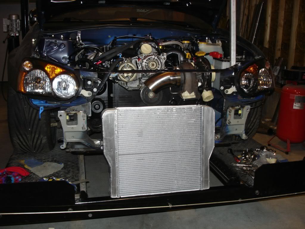

Some pics of the current progress on the new setup
PWR radiator with custom end tanks

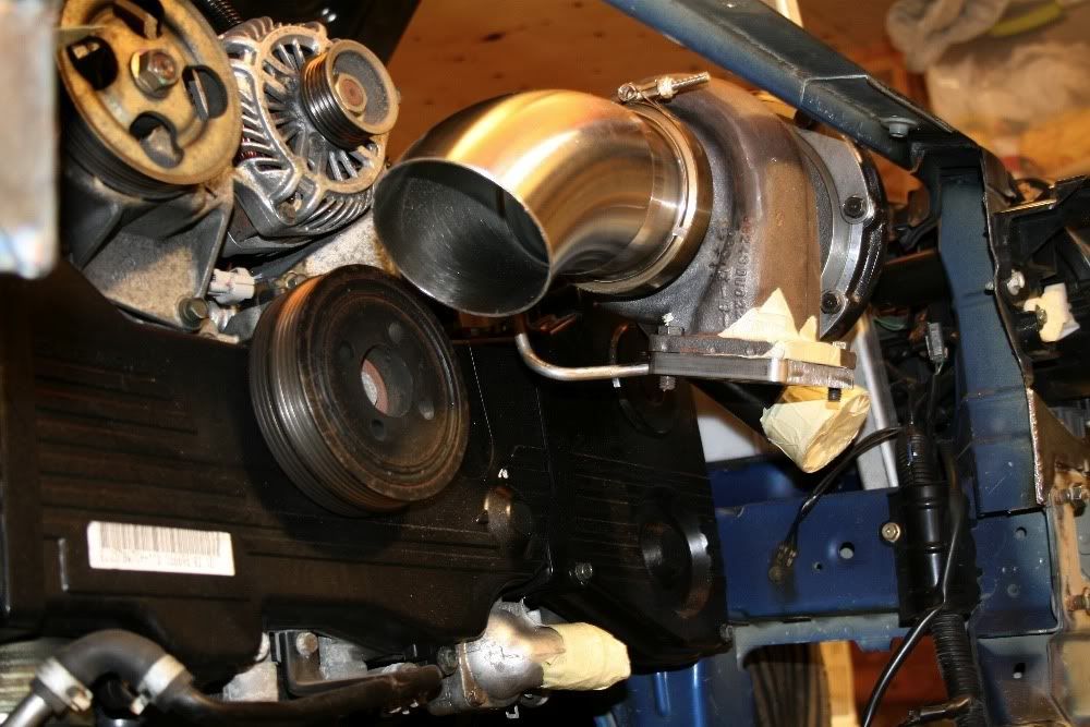

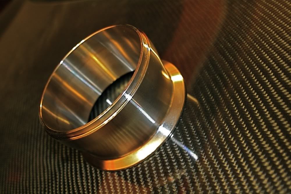

custom CNC'd 3-4" reducer

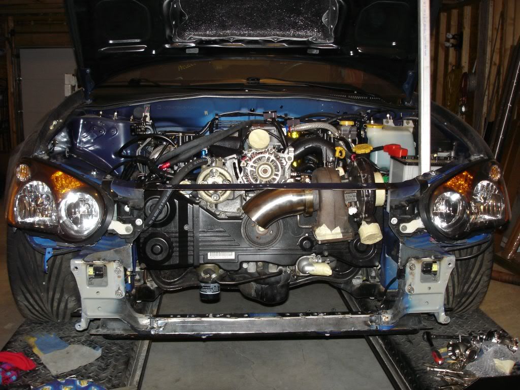

New turbo location

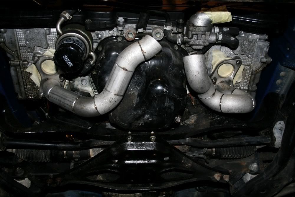

The new twin scroll header

Some header fab updates. The last pic shows how horrid the stock crank pulley looks - time for a Perrin light weight pulley.

Thanks for all the positive comments. The local fabricator here does some crazy work!! The last few bits that will be created are titanium charge pipes and catch tank :) should look real trick.

In the mean time here's some more pics.
Header all finished
header installed with a picture of the downpipe
