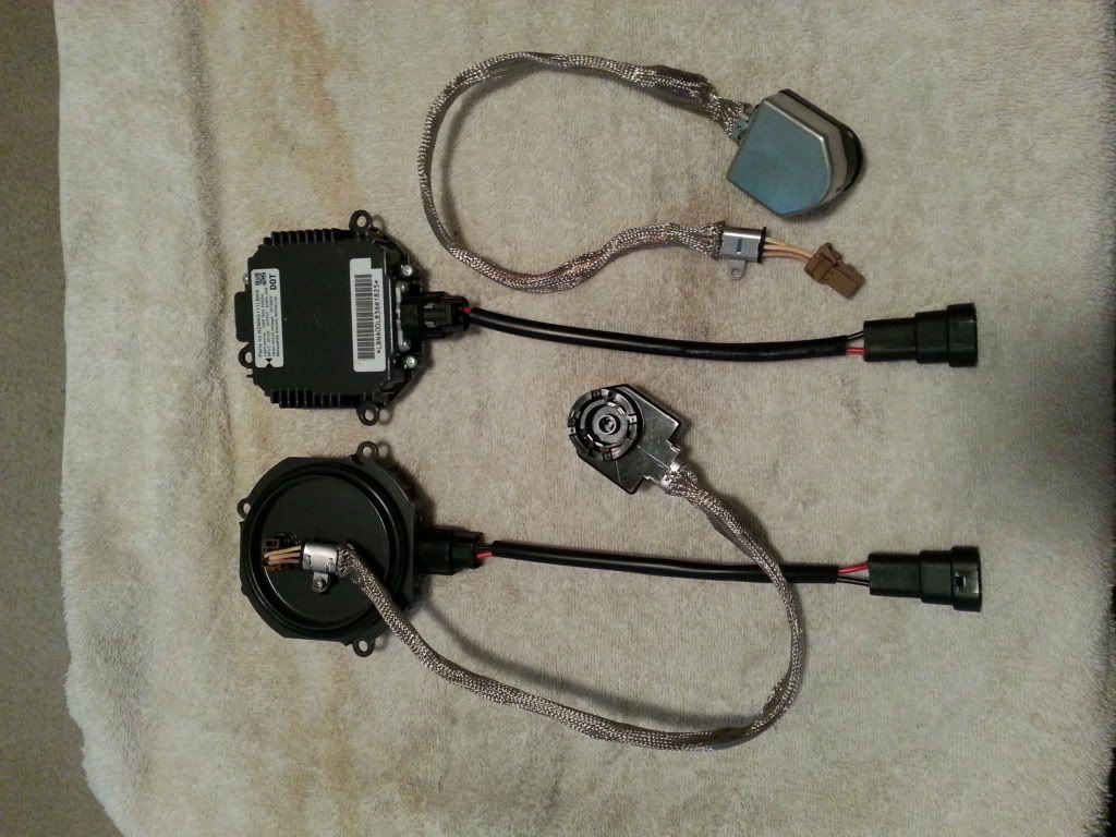

ballast is super simple to get to. It bolts up to the bottom of the headlight housing. Only difficult part is you will have to remove the front bumper to either remove the light and/or replace the ballast. Here is the pic of the ballast itself. Sorry dont have a pic of it attached to the housing. Its held on by 3 self tapping screws.

Found a pic from Japanese blog that comparing the size of the Matsushita Gen IV and Gen V ballast side by side. The OP said there is barely changed inside the ballast in Gen V

eBay part came with Ballast & Ignitor. I think it was $70, lower than the quote from Burlington Subaru was ($300 for ballast, $120 for Ignitor, then add Labor to that).
