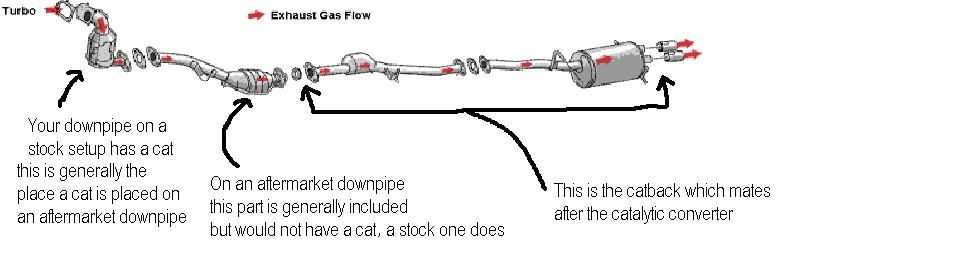

Q: Is there a diagram of the complete exhaust system?
A:
In the diagram above, the first piece is the downpipe. Next is the catylitic converter, however, this piece is commonly combined with the downpipe and is actually 1 piece. The third piece is the center-pipe (or mid-pipe) and finally there is the muffler (or tailpipe or axle-back exhaust).

cat back is kind of misleading. almost every aftermarket sti downpipe ive seen has the cat placed pretty close to the turbo. so technically a cat back exhaust should be called a downpipe back exhaust, but they've been called cat back forever, so no one is going to change that.

Yes, all you would need is a downpipe, but it's your choice weather you want a catted or non-catted one. The catback actually mates after the catalytic converter on a stock setup hence being called a "catback."
