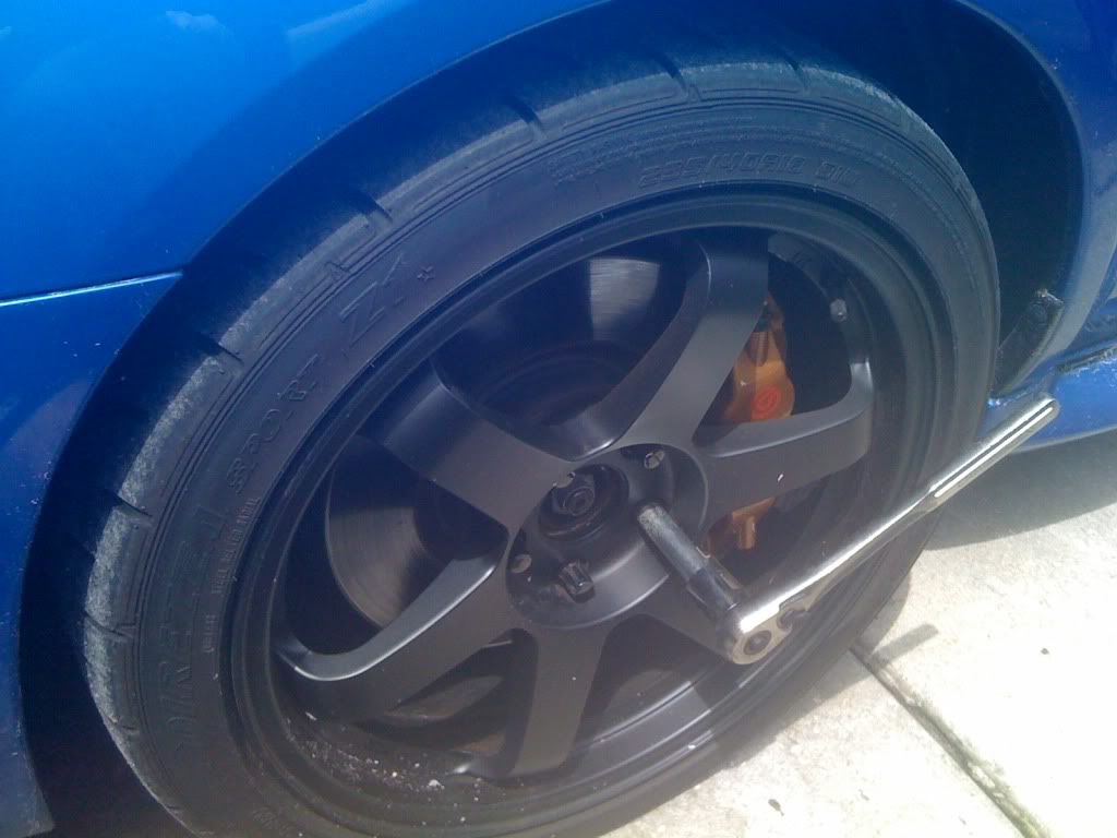

First break loose the lug nuts on the wheel(s) you will be doing first(I know my wheels are filthy).

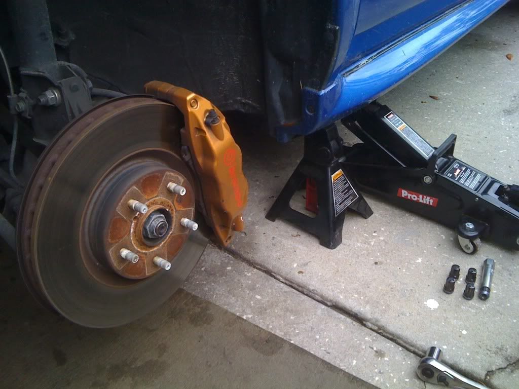

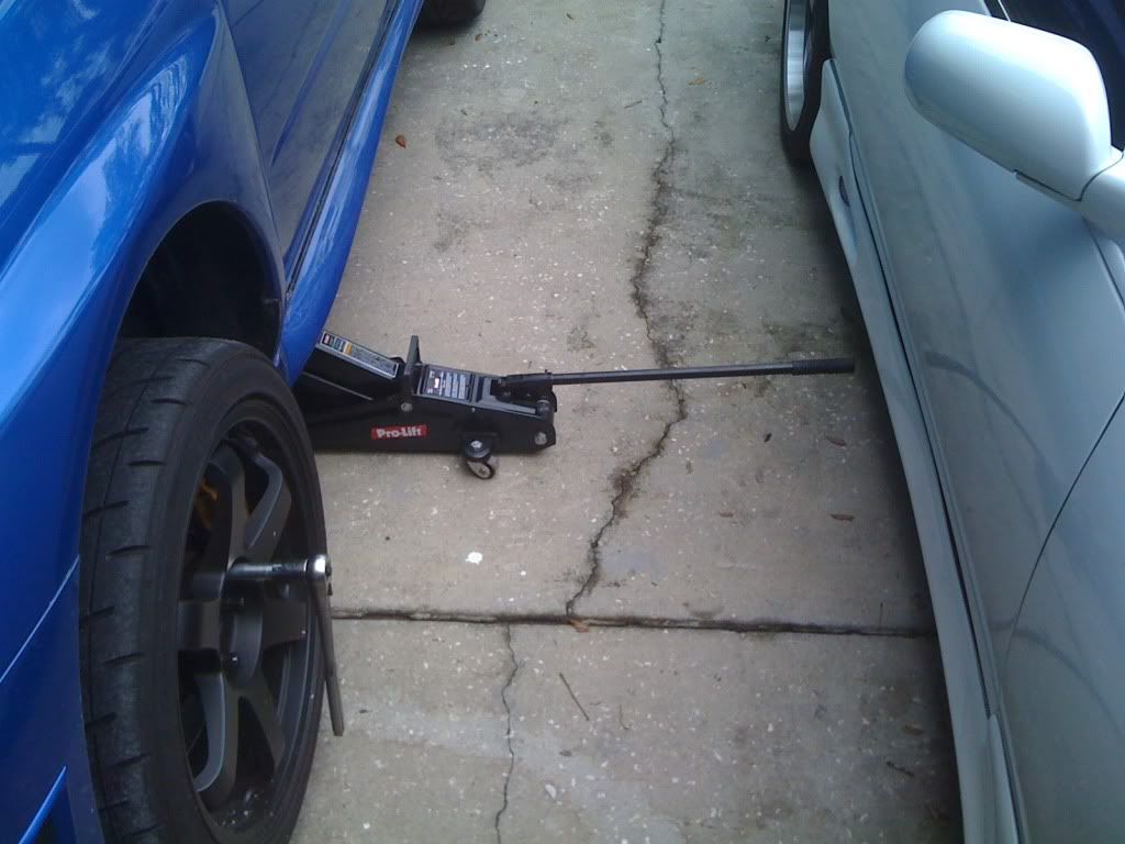

Next jack the vehicle up at a solid point. For the front, I jack it up at the indention underneath the side skirt, and for the rear I jack up the rear diff. Then maneuver the jack stands into place, all without hitting your roommate's 300zx.
Next loosen all lugs and take the wheel off

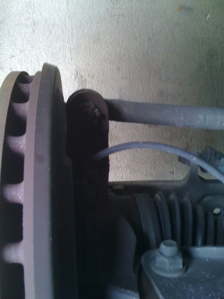

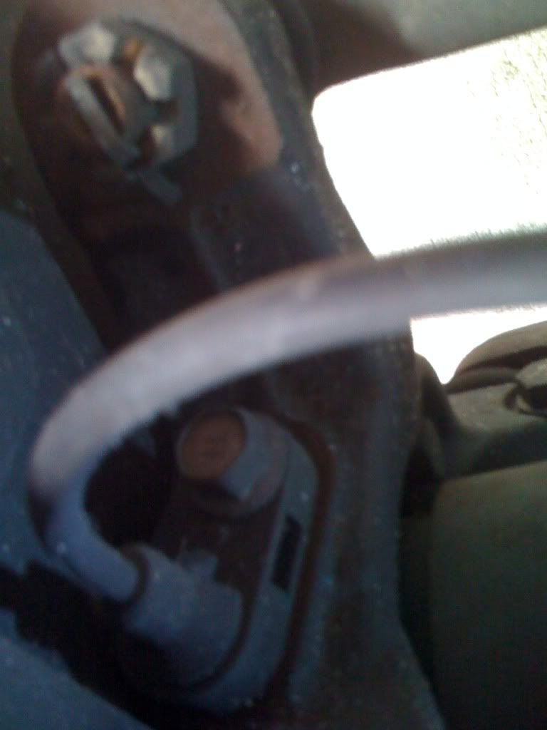

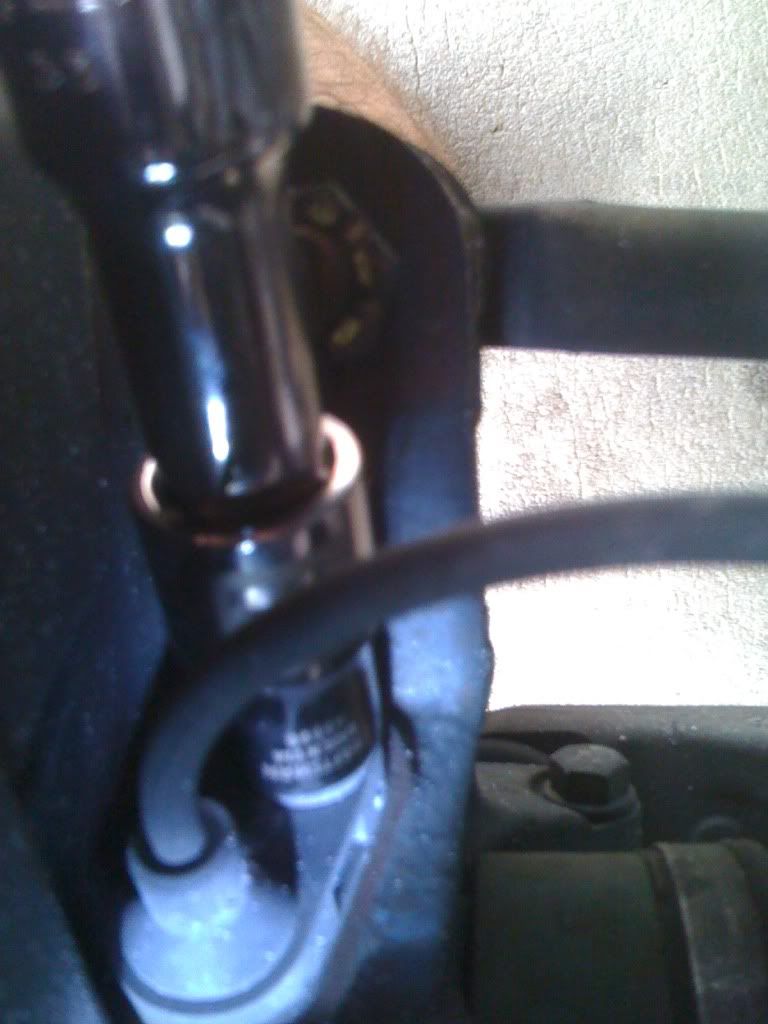

Next, locate the wheel sensor behind the rotor(it has a cable, not the brake line, attached to it)
Loosen the 12mm bolt holding the sensor in.

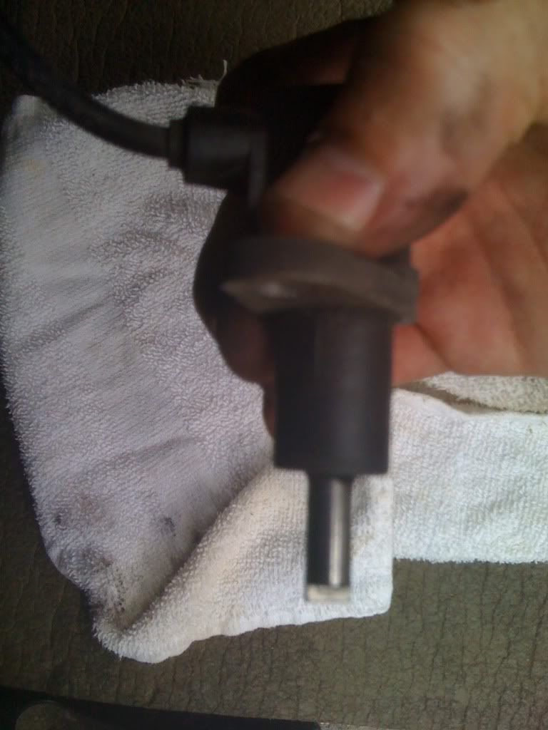

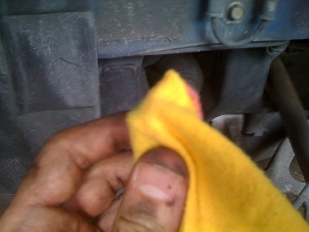

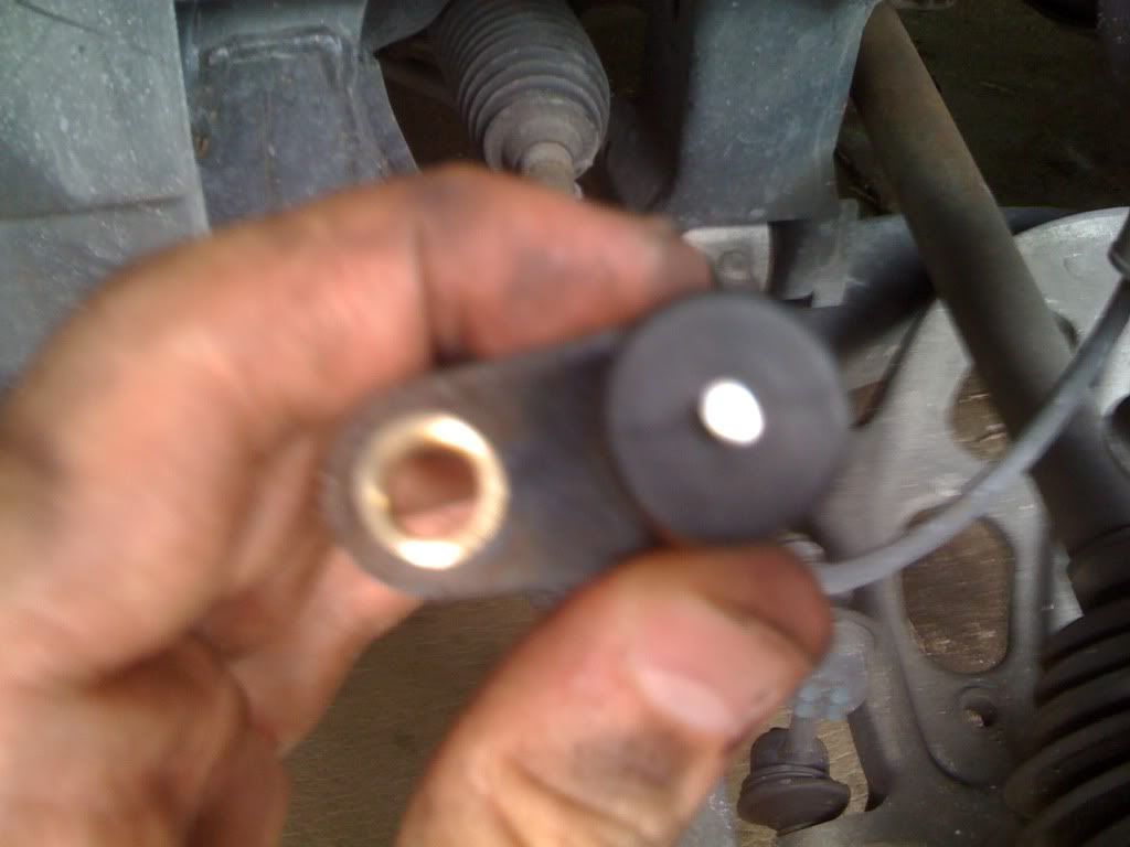

Take the sensor out a see how dirty it is. I cleaned mine with a shop rag and no cleaning solution, so as not to screw up the sensor.

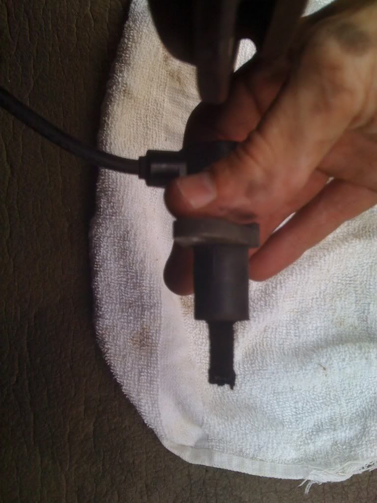

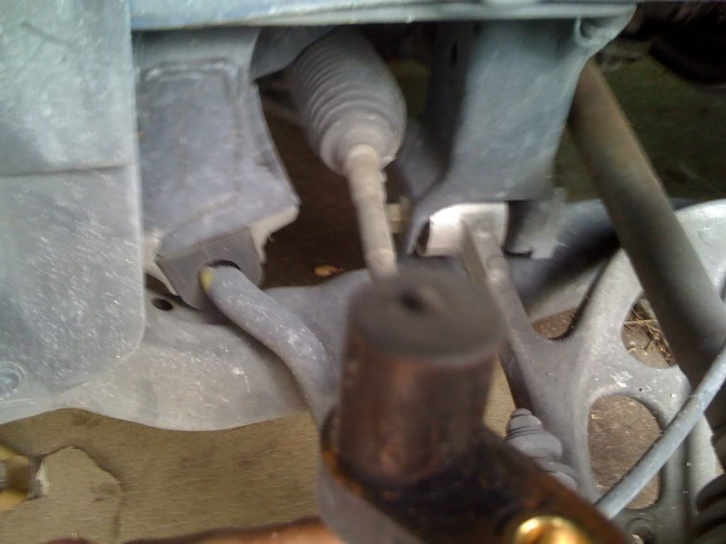

Those were the sensors on the front, the rears are a lot longer, and dirtier as shown here.
And cleaned.....
Reinstall in reverse order and you are done. There are no torque specs for the 12mm bolt, so 'good-and-tight' is what I did.
