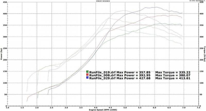

Car on the DYNO at TSM
Green- 91 Octane (Super conservative due to lesser quality ACN fuel in Arizona)
Red- 93 Octane
Blue- MS109 mix with pump (for engine health, I added the MS109 with the car on the dyno as soon as the low fuel indicator light came on, therefore the more fuel you use with the low fuel light on, the safer it is to run the MS109 on the track)
2010 STI MS109/93 Octane/91 Octane tune - YouTube
