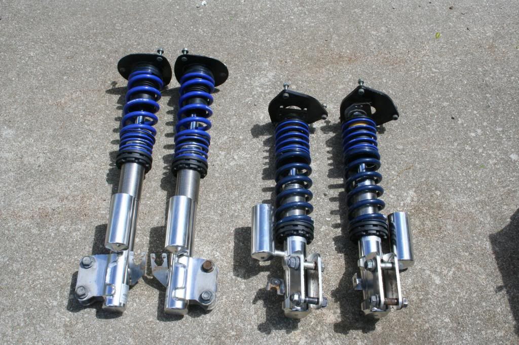

#1 priority was suspension. I started shopping for something like BC's, but ended up finding a used set of RCE T2's that already had the 600lb f/500lb r springs I wanted and valved to match.

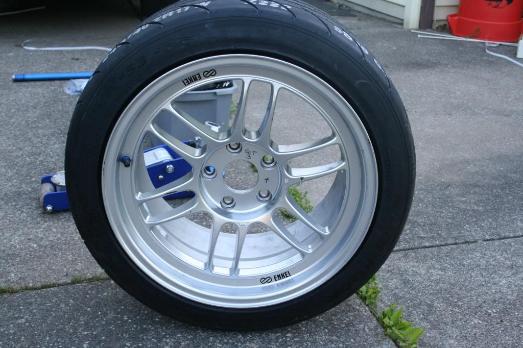

Next was wheels. STU limits you to a 245 street tire, but leaves the wheel unrestricted. I had the stock BBS's I could use, but the top level STU cars are running much wider wheels like a 9.5". What would be ideal is the 17x9.5 +38mm RPF1. Oh hey, I had just bought a set of those for the Nissan. That was really convenient!

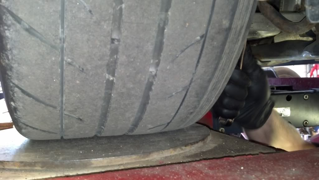

And that's where I ran out of money for modifications. So, I bought a set of RS-3's, and started racing. Due to some poor decisions, like not getting an alignment, I chewed up my front RS-3's with less than 2000 miles, 1 autocross, and 30 minutes on track. I'm not proud, but it happened.
