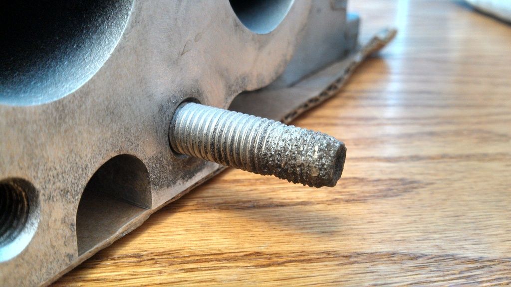

In short, I would not recommend this company to a friend based upon my experience. What I received did not meet my expectations. Please refer to the attached photos.
Packaging: The heads were shrink wrapped and placed in a small box without any packing material or protection from damage during shipping. The boxes had many holes from the studs and spark plug tubes poking through. In fact the tubes were partially showing through the box.
Packaging Damage: As to be expected the spark plug tubes were bent at the very edge that was protruding from the box. Edges of the head along the mating interface had dings that raised the material that could potentially degrade the head gasket seal. I stopped my inspection there.
Gasket Mating Surface: One head had been decked but had corrosion on the surface along one corner. The other head had not been decked and had a light indentation where the previous head gasket had been installed.
Cleanliness: The heads might have been placed in a parts cleaner, but they still had debris in a few places on the internal components as well as the outside.
Valve Job: I have no reason to believe anything was wrong with the valve sealing interfaces, valve components, or final adjustments as I did not inspect these areas/components. However, one head had aluminum removed around one of the exhaust valves with material protruding. I do not believe this to effect form fit or function, merely a workmanship/cosmetic issues that is easily fixed.
Exhaust Studs: The studs that came on the head were not usable since they were badly corroded at the ends. This is as to be expected on a older model engine. However, I expected these to be replaced if they were in this state of disrepair.
