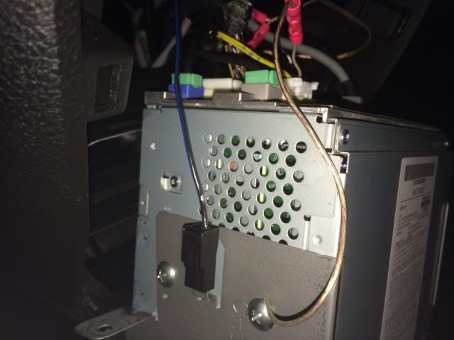

My bad! I didn't update with my progress. Yeah I got it to work, but the pioneer head units make it a little bit harder than just grounding the handbrake wire. Regardless, it is super easy. I'll try to explain it from what I remember.
So what I did was just take the yellow mute wire that is on the end of the plug on the back of the head unit, and put it in the slot next to it. After it's in, I just grounded it to the chassis of the head unit itself.

I have a 2013 STI limited. I did this off another forum
"Easy Peasy. Pull the head unit out. Look for the gray plug. One wire is sticking out of it. Cut the wire in the middle. Take the wire that still connects to the connector that plugs in the radio and ground it. Problem solved."

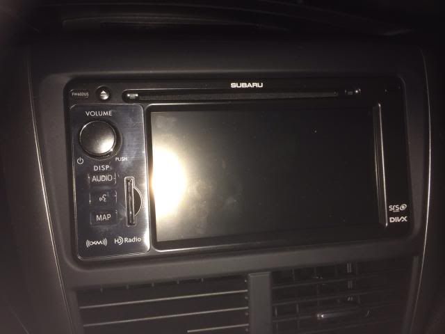

Posting mini how to, this should answer pm's also if you mess up your deck its not my fault do this at your own risk and know your own laws
My head unit
Gray wire you need to cut
How I grounded it EASY just used speaker wire no issues with many movies watched.
I did add on a switch in a different spot that was suppose to do something which didn't do anything as seen in the photo just ignore it.
