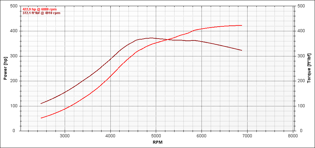

Special thanks for WolfPlayer for the help with Launch Control... and... Ed at EQ Tuning, Jeff (crystal_Imprezav) & Shawn's brain for all the advice, dyno plots etc...
I was limited to 26psi due to lacking fuel (850 injectors, stock fuel regulator, one fuel pump = not enough fuel for more than 26psi)
Sill was able to get into the 11's.... the launch control works GREAT to assist with improved take off. I actually think it causes less shock to the driveline as compared to my normal launch (pump throttle & step off clutch like you would step off a pile of warm dog $h!t with bare foot)

Here is the the dyno plot made an hour before track time:
