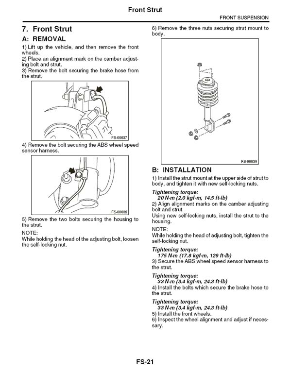

The only caution with the front strut bar install is be careful not to overtorque the nuts. The spec is around 14.5 ft-lbs and many have broken them by going over.

torque specs at B1
