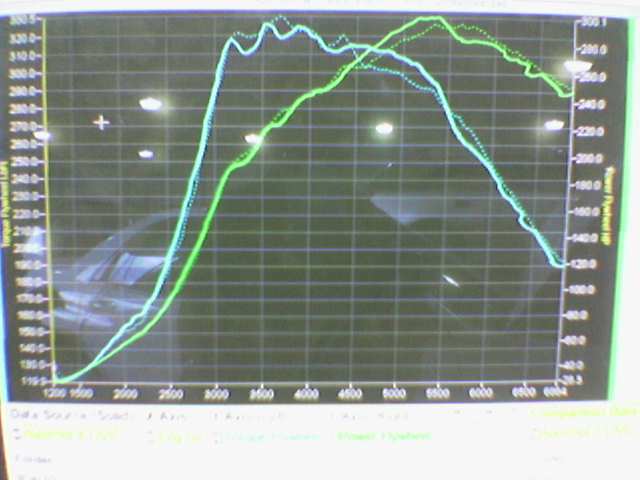

Just got another customer's '05 STi off the dyno. ONLY mods, TBE, fuel pump, Perrin EBCS, Ecutek. 330.5 wlb-ft. I played for a WHILE trying to get the whp up, but without adding a spring to the wastegate I just couldn't get the boost at the top. Tried everything from 11.0 afr to 11.55 afr and timing from 26.5 to 32, wouldn't make over 304whp.
Check out the plot: (sorry about the phone pic, I'll get the real screenshot on Monday)
http://www.siegelracing.com/kellydyno.jpg
the dyno does funny things with boost control. On the road (after the dyno) the boost and engine load graphs, as well as perceived power, were PERFECTLY smooth.
SS

330 wtrq! I could care less about the hp. Great work scott. And damn you for not being in Ohio... or within driving distance :-(

then to make matters worse...
the 385 whp pull on the dynojet was with scott running a bit over 20psi.
i later find out that the map was detuned for less boost.
yet no final pull was done to show what i was actually paying for.
i was under the assumption i had a 385 whp tune.
what do you think?

as i mentioned i don't have a problem with scott as a person, and do not doubt the results he has achieved on some cars.
what bothers me is that:
a. i was led to believe my car was making 38x whp not once but twice.
b. i was 'given $1690 worth of tuning'. the results would say otherwise.
c. i was told they (s.o.g.) had tuned 20g setups with 365+ whp. no dyno results there though.
d. and to top it all off, when i was not totally jumping for joy at the 380 whp, i got to listen to some of the guys tell me how i should be happy with what i got, and that 380 whp is 'alot from a lil ol 4 cylinder'.
guess what? you want me to be happy? you pay the effin bill!
i should have just pulled my back out taking my car off the dynapak myself. then the tuning might have been free
j/k
i will be sure to get a before dyno pull at my expense before any changes are made.
then i will post the results of what my car is putting down.
