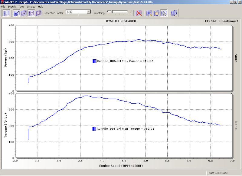

Default 2006 STI - 312whp/383wtq (Update: 5/24/2008)
tazer
Numbers (22psi target boost)
Dyno: Dynojet - Rad Motorsports Waipahu, HI
Tuner: Jarrad - PDX Tuning
Wheel HP: 312
Wheel TQ: 383
Ambient Temp: 93*
Elevation: 127'

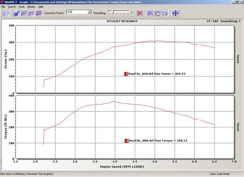

Old Numbers (19psi tapering to 14psi at Red Line)
Wheel HP: 309
Wheel TQ: 360
Ambient Temp: 87*
Elevation: 127'
Car Info
Year: 2006
Engine Management: COBB AP v1 + DTEC Boost Controller
Turbo: Stock VF-39
Intercooler: SS Autochrome FMIC (TXS knock-off)
Meth Kit: none
Injectors: Deatschwerks 740cc
Intake/Inlet: SS Autochrome Short Ram (came with FMIC Kit) w/ K&N filter
Headers: Perrin Equal-Length (ceramic coated)
Uppipe: Stock
Downpipe: Auto Dynasty (generic e-bay TBE kit) ceramic coated
CBE: Auto Dynasty (generic e-bay TBE kit)
Other Power Mods: Walbro 255lph fuel pump, 1-Step Colder plugs (iridium), Pump Gas: Tesoro 92 (E10) Old Gas: Shell V-Power 92
Link to your tuner's rating thread:
http://www.iwsti.com/forums/review-s...nolulu-hi.html
New Chart
Old Chart
[Discuss your experience and future plans go here]
Thinking that a 20G or a FP Green is in my future.

pics updated. (dyno chart)
PSI: 19psi, tapering to 14psi @ redline

Looks good. Your front mount isn't lagging you too much. Probably offset alot by the header and small core size.
Congrats.!

I'm sure it'd have made for a bit more (just a little bit more) power, might have confidently broke the 310hp mark,... but, from discussions I've had with Jarrad @ PDX, a good boost controller (DTEC - already have.. just need to install/tune) would have sustained power longer
Curve in the beginning of the thread is 19psi peak tapering off to 14psi @ redline... so... holding boost is the next target... dunno if I'll stick with the VF39 as an opportunity has presented itself to me... but we'll see.
