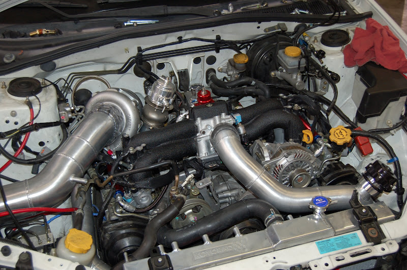

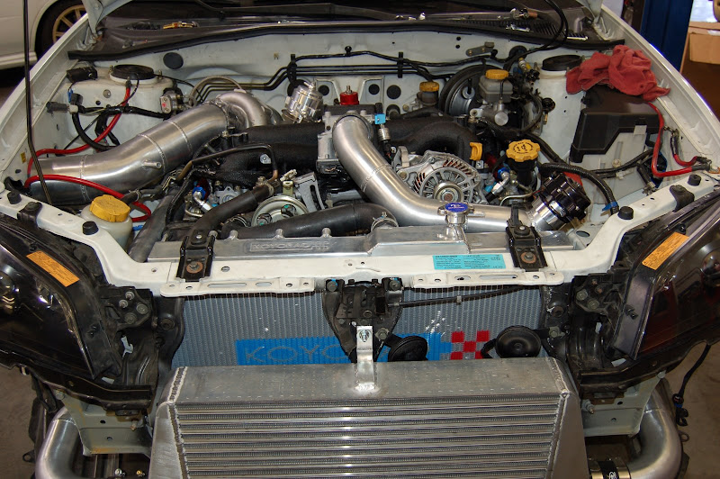

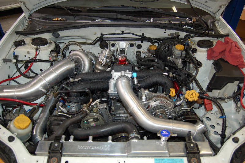

yo if you dont mind me asking about how much did you spend on that setup? and are you satisfied with how it turned out. it looks amazing by the way.

i spent quite a bit...the full-race kit cost which is on there website...and install with harman and custom piping and fuel...total $10k+

What throttle body is that?

It's stock it's just flipped around.

looks awesome blaise, they are really doing an excellent job on the install. One thing to note, however, if you do want to do time attack, you may want to consider using a twinscroll T4 GT35R. This turbo would boltup perfectly using the same downpipe and up pipe, and would offer a much more time-attack friendly powerband. the 40R is so ridiculously fast, it would be tough to drive in a time attack application, and annihilate your brakes
Originally Posted by Blaiser View Post
Ok well huge update today, im pretty stoked about it!!!
all the piping and fuel system is done, just a bit more to go!! enjoy!
love the pics!!!!
