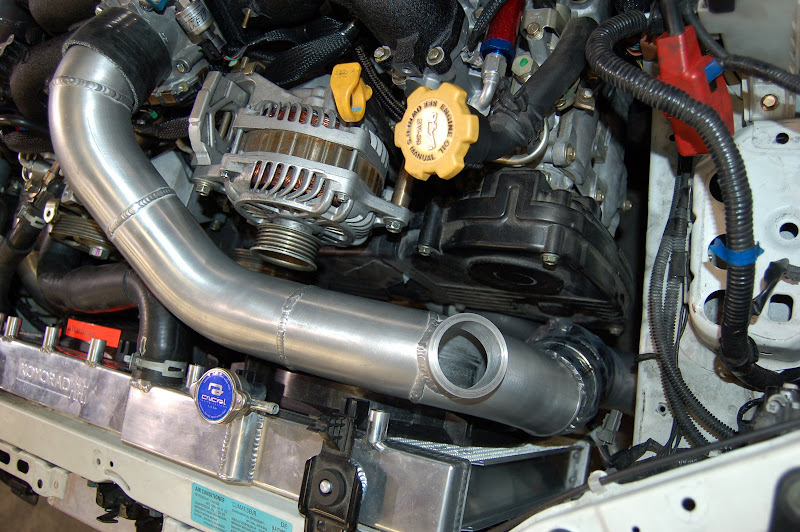

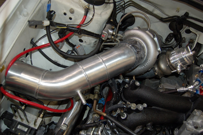

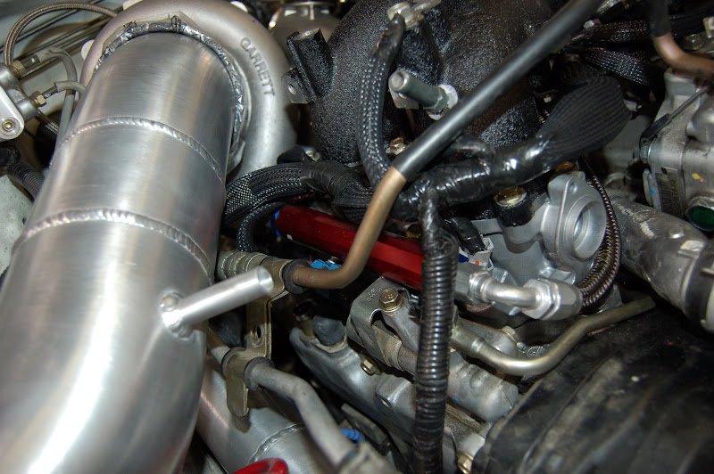

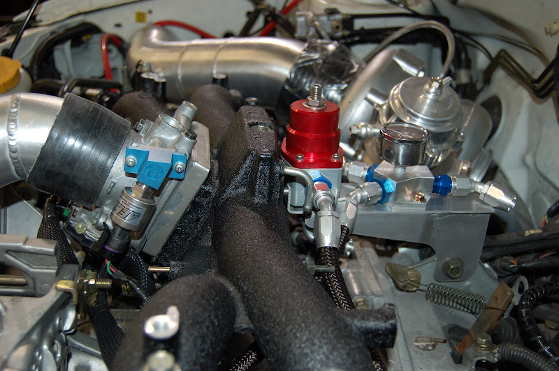

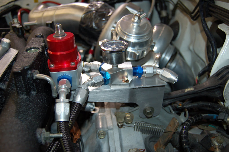

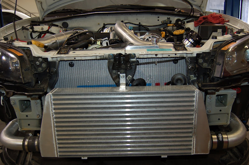

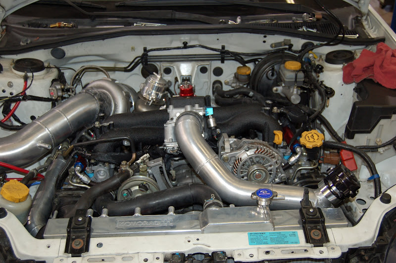

Ok well huge update today, im pretty stoked about it!!!
all the piping and fuel system is done, just a bit more to go!! enjoy!

Couple questions, what do the grimspeed spacers actually do? I've heard about them, just no info. Also, what are the specifics on the intercooler? Did you have to make custom brackets to make it fit a subaru, or do they sell it for our cars specific?
I assume you have the old design full race up-pipe considering they now run a twin wastegate design.

i actually couldnt use the grimmspeed spacers because the piping wouldnt clear with the hood shut. they basically create a barrier in between your intake manifold/tgv's and the hot ass heads. allows for cooler intake temps and i guess the were texted and helped up to like 30 degrees...im bummed i couldnt use them. the intercooler is 100% custom. it was a 24x12x3.5 core....custom endtanks, customs brackets and everything.

Sick! I am going to be running the 4088r also, single scroll though. I wish I had the scratch for the Full-Race treatment, there stuff is the real deal. Good luck with the project, I will be staying posted on this. Fuel system is nice, do you have a surge tank also? Would like to see more pics of the fuel system completed...What throttle body is that?
