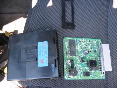

Step 4: Wedge a flat head into the “Integrated Module” to pop off the plastic cap piece. Once it is off, hold the grey wiring harness connecting piece and carefully pull. The green mother board looking chip should slide out now.
Integrated Module with cap popped off

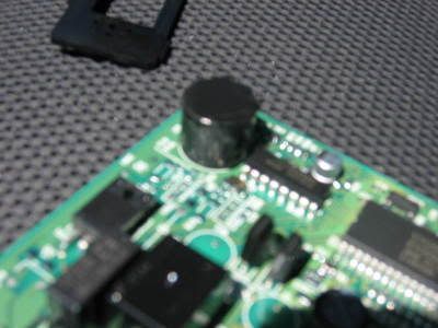

Step 5: Use electrical tape to seal up the speaker. (I am not too sure about how to remove this speaker, so all I did was tape it up.)
Speaker Sealed up with tape

does that really stop the sound from coming out or just make it really quiet

probably just makes it really quiet.

At least the OP located the chime, so maybe the industrious few among us can just desolder it from the board.

correct. you can still hear it, but it's very faint.

I did this on my truck. I couldn't get the speaker off and was so pissed that I just shoved a screwdriver into it and scrambled it's guts.
