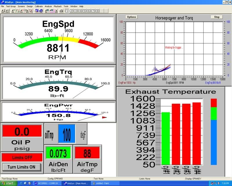

If I recall correctly, most instructions for EGT thermocouples say to place them 3-4 inches away from your cylinder head, also, its a good idea to place the thermocouple in your leanest cylinder i.e. #4 runner.
Like about here

someone from NASIOC posted this on my thread there and from this test it looks liek the #2 is not far off the #4.
