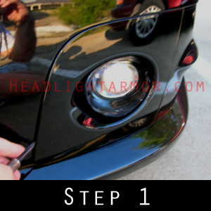

Step 1: Pop off any garnish or surround that may be in front of your lenses. Clean the lenses. Clean your hands. Make sure there are no residues from the cleaning process remaining on the lenses or your hands.
Without removing the lens cover from the backing paper hold it up to the lens and make sure you have the correct one / orientation (i.e. Slightly ovoid lenses).

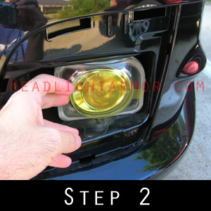

Step 2: If it is cool - below 65 degrees F gently warming the material with a hair dryer will help things along.
Carefully remove the cover from the backing paper - handling along the edges or with any handling tabs and gently place on the center of the lens dry.
You want to make sure you have them centered properly as the adhesive is very sticky.

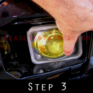

Step 3: From the center out to the edges press the piece down firmly with your thumbs, being careful not to trap bubbles of air.
You are almost done. Go over the edges with a paper towel, pressing firmly to make sure all the edge is firmly sealed.
If it is cool - below 65 degrees F, going over the edges with a hairdryer on low can help the process along.

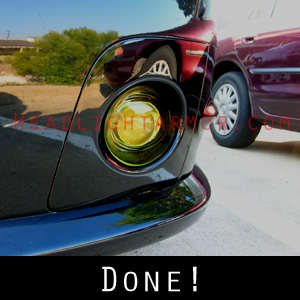

Re-install any garnish or surround and NOW you are DONE, yes it was that easy.
