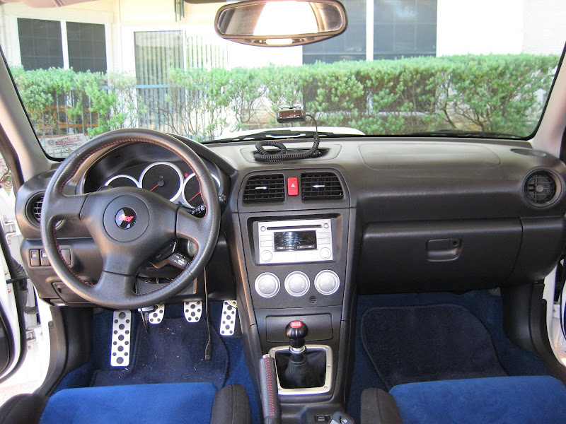

Default Re: How To: Flat Black Interior (work in progress)
biker921 is offline   Reply With Quote
^^ looks awesome. what paint did you use?

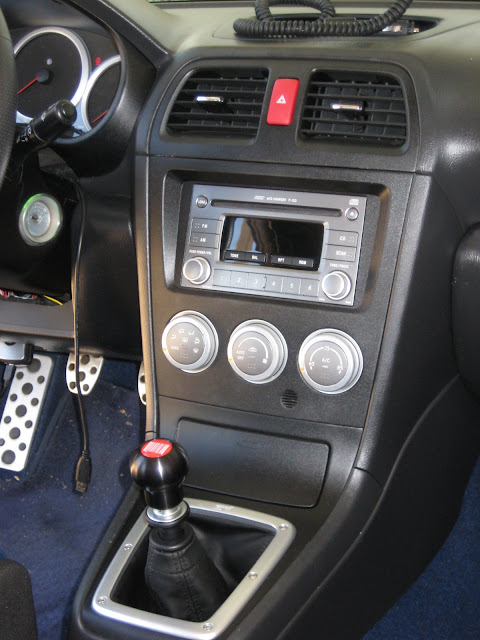

did mine a lil while back
