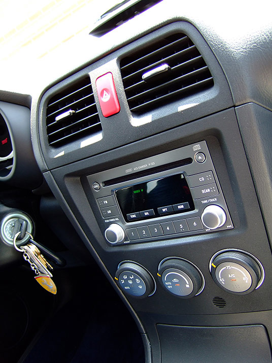

- JDM Red Hazard Switch

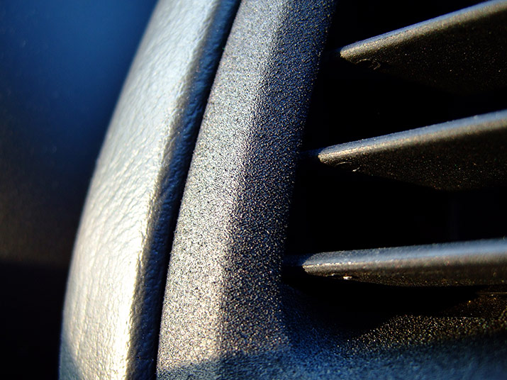

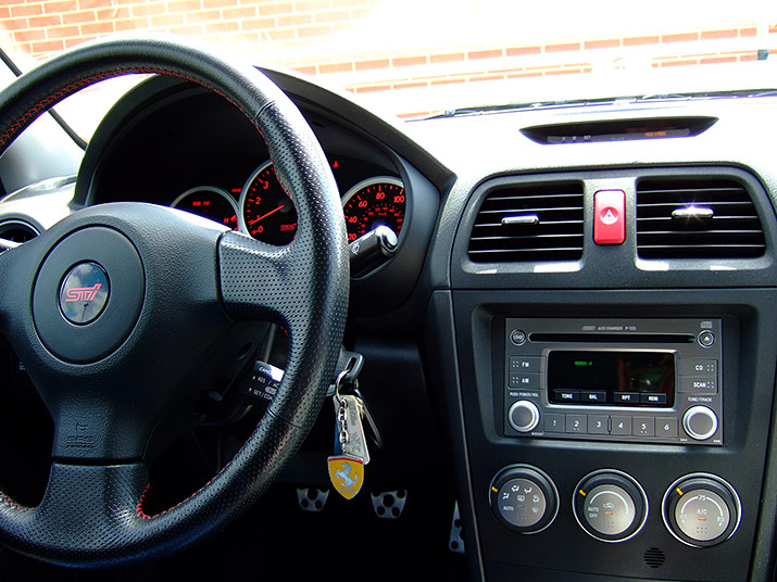

Plasti Dip Center Dash: I was able to achieve a sort of crinkle finish to it by spraying about a foot away. Its held up perfectly for over a year now

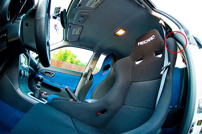

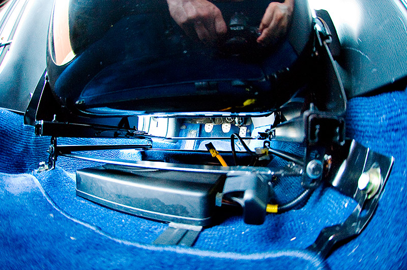

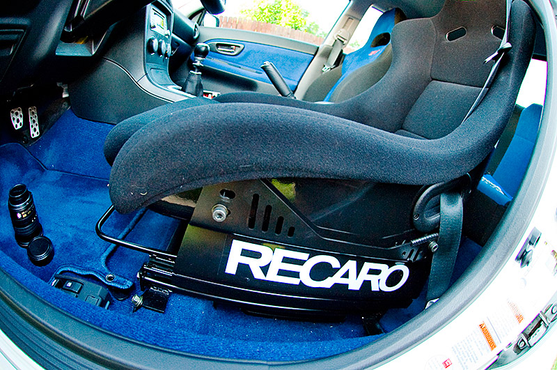

Recaro Pole Position seat: The best daily driver mod. I HATED the stock STi seat with a passion. Aside from sitting too high for me, the thigh support was hard and short and actually cut off circulation for me on longer drives. Not to mention it just didn't hold me at the track at all. I don't miss it one bit, aside from the safety of the air bag.
Still able to keep the stock Sub/Amp

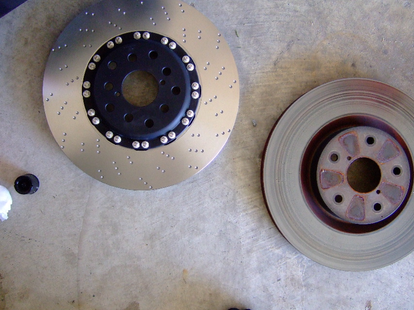

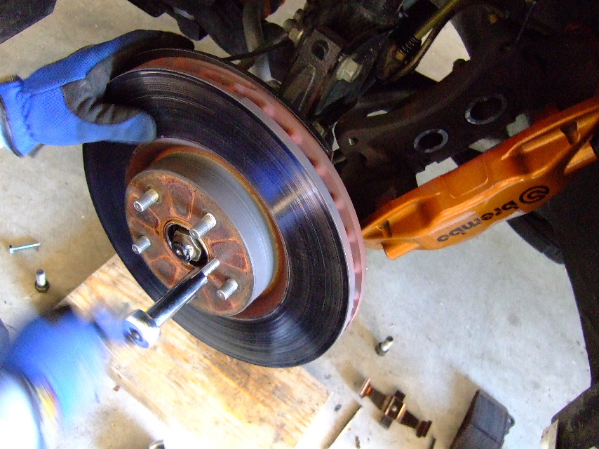

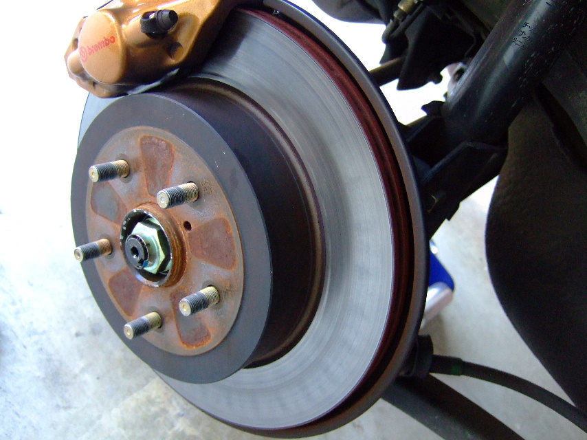

Now my number one Achilles heel for the car I feel for the track is...Brakes: The stock Brembos with upgraded Pads, lines, fluid did me well for a while, but I eventually got faster and am pushing the car more and more out at the track and would go through pads in 1-2 days at most. When I bled the brakes I would get minimal air in the fluid, but the heat checking on the rotors and ability for the pedal to recover between some braking zones diminished as I picked up speed and put more heat into the brakes. I felt like I needed better components to handle the heat and went up the Carbotech latter on pad compound over the years and recently changed rotors. I have the Kool Brake Kit on order and hope to get those in this week, as the last time I took temp readings on stock Brembo rotors the temps were upwards of 800 degrees at the rotor, and the wheel balancing weights actually started melting off.
I have a long thread here about it all: Brownbos, cooking brakes on Track: Bad cooling... or bad driver!?
So anyway this:

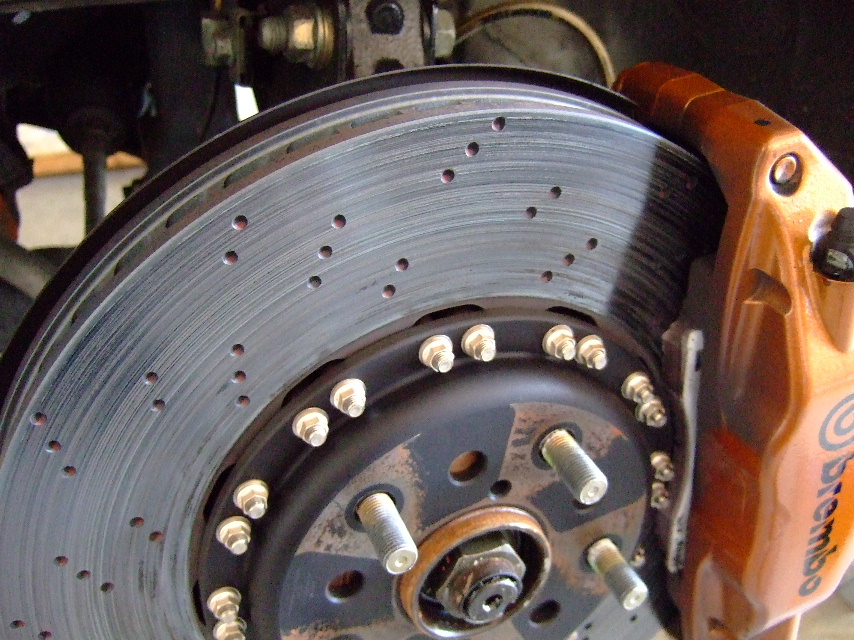

and this (these are after being resurfaced once already with similar cracking(the dents are not from braking)):

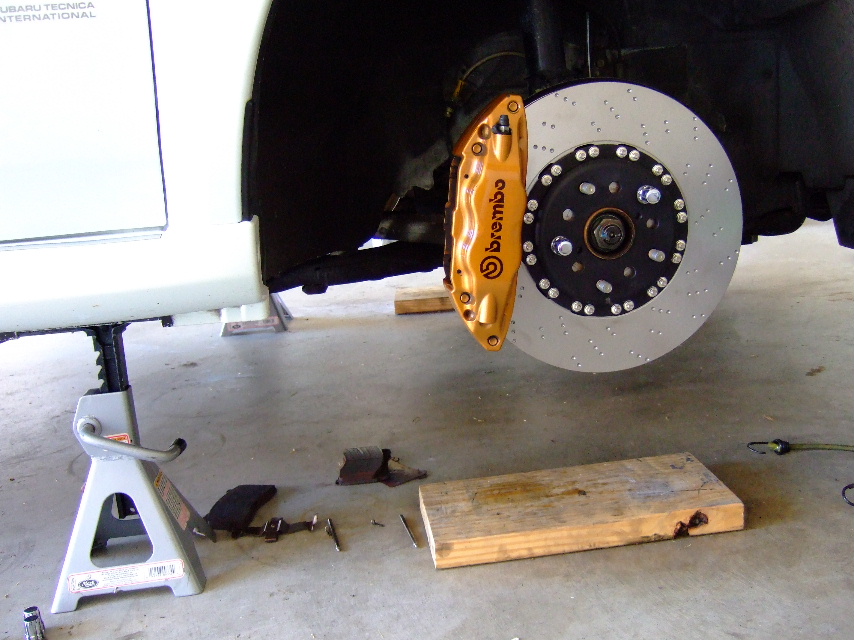

led to these and Carbotech XP10 front pads and XP8 rear pads:

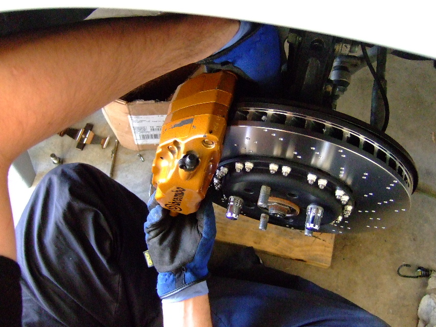

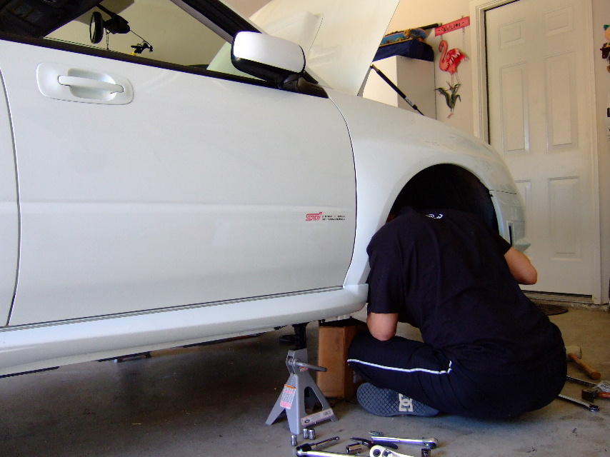

installing
so pretty

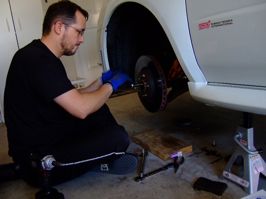

the brembo rotors were seized on pretty good. I had to run to Lowes for n 8mm bolt to release them
done and ready for the track

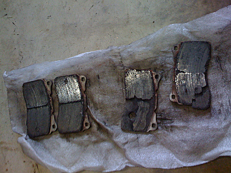

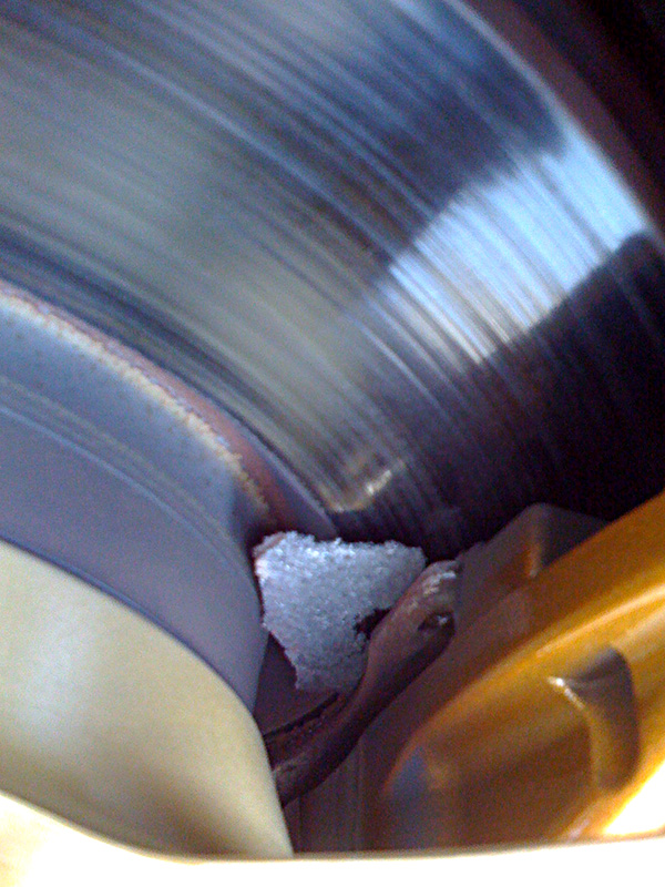

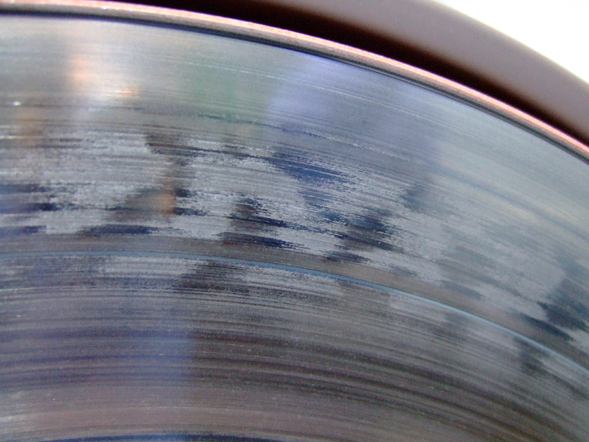

So after my first track day on the new rotors and pad compound I have to say the improvement in braking was definitely noticeable. How much of it all was due to either the rotors or the pads I have no idea, but the combo proved to be great. The braking performance on the track was paired with new stage 2 power via Cobb downpipe and a Protune (more on that later) so to me the car felt completely different and took some real adjustment and getting used to. I actually was at first braking like I had previously with stock brembo rotors and XP8/AX6 combos and realized I was over braking by a huge margin. The new combo even with the added power down the straights meant I could go shorter and deeper than ever before, but getting used to it took me until the end of the day. This wasn't a normal session for me as I was also instructing this past weekend and didn't get as many or as frequent a session as I used to, so I really only got dialed in at the end of the day, and each time had passengers.
In any case, something funny is you can hear the dimples on the rotor surface under braking with the windows down. I noticed zero fade and plenty of consistent stopping power, but never got to get a single temperature reading as I pretty much jumped straight into student cars, or forgot after a session. I did still notice on certain sections of the track that the pedal hadn't fully recovered 100% between two big braking zones, leaving me with the impression that not enough air had flown over the brakes to cool them down, where in other sections, there was enough speed and time to get them cool enough to bite harder. So I'll be curious to get temp readings and impressions once I get the RCE KBK on the car and get out to the track next month.

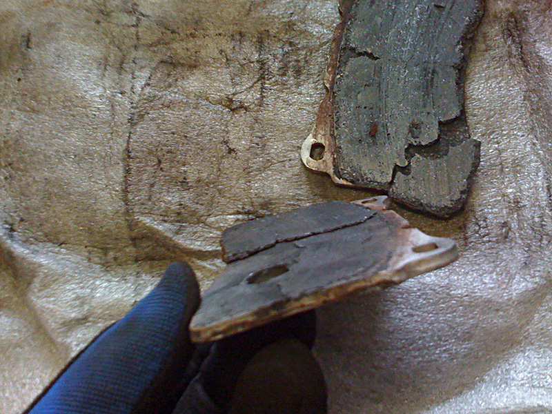

So after the first track day on these, the Carbotech XP10 and XP8 pads looked like they suffered minimal wear and held up great. I'm excited by this for sure as it means less cost in the long run if I can get them to last more days. Of course my tires I use for the track (Yokohama Advan AD07s 245/40/17) are pretty much at the end of their life, and I had them flipped on the rims to get a little more use out of them. Unfortunately this last track day was run in the opposite direction we normally run, which was only a problem since I had the tires flipped to take advantage of the better shoulders on one side, only to have to beat on the more used side. :P

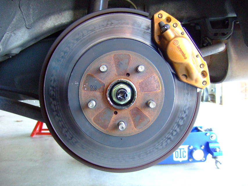

So after the one day the pretty new rotors look like this. I followed the instructions for bedding and had no issues that I could tell, but does this NOT look normal to anyone?
The driver's side Caliper turned more brown-ish than the passenger side, but wear looked similar
They look smeared...???
The stock rear rotors look like you can see the vein structure underneath...??? What's up with this??? Does this mean they are about dead too?? Or nothing to worry about????
Driver's rear

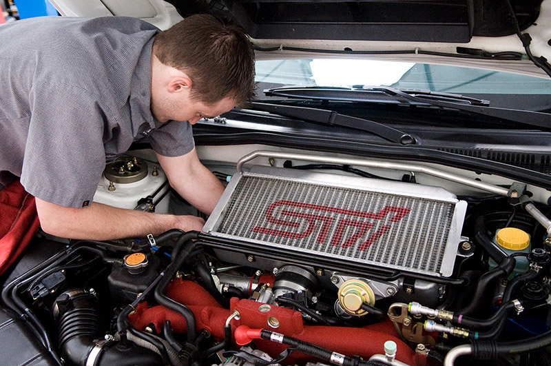

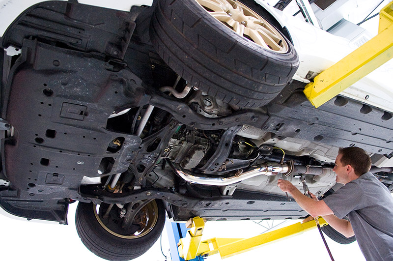

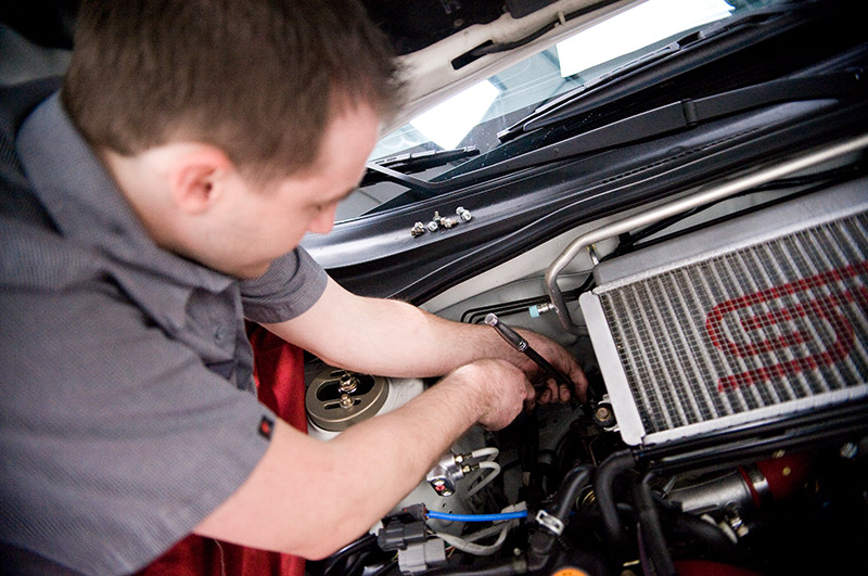

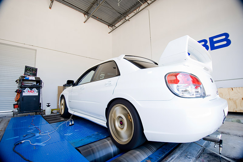

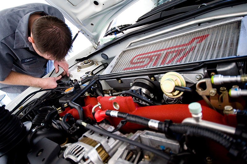

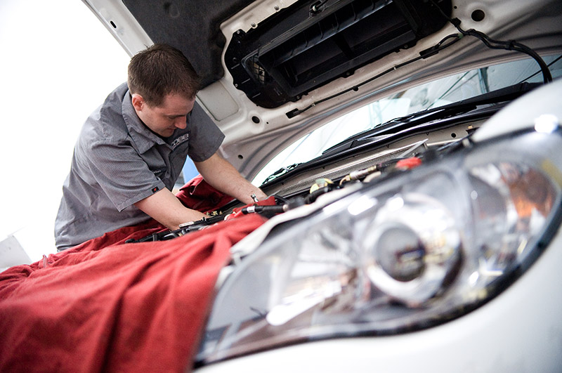

Within the past two weeks I came upon the opportunity to add more power via a Cobb catted (gotta be catted for me) downpipe and a Protune at my friendly local Cobb tuning of Plano. I also added a Prodrive 3-port boost solenoid which it was also tuned for. Calvin, the tech who did all the work and tuning on my car did a great job and so far I'm a happy camper. He spent the good part of a whole work day on my car, tuning it to run a safe but fun tune and in the end the numbers are pretty good although honestly I haven't paid much attention to other's protune results as so many of the components vary and it wasn't on my radar until suddenly recently really.

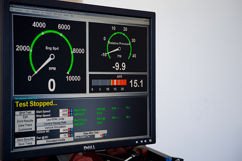

We didn't do a Dyno pull with the car in stock or Stage 1 form, although that would have been interesting to see how much it changed. Under stage 1 I did get overboost a couple of times on highway acceleration in high gear and in cold weather and once recently on the track while pulling down the straight in fifth gear. So I re-flashed to a stage 1 low waste gate map and that pretty much cured that. So after the DP was installed we did a baseline pull to see where to car was at with the DP, stock boost solenoid, and off the shelf stage 2 map and got a gnarly boost spike early in the revs so Calvin actually did some of his magic on the tune and we eventually came up with a baseline of 273whp and 303wtq.
After the Prodrive boost solenoid install and much time tuning and many dyno pulls later we had some pretty nice curves and safe looking power.
Some pics of the day

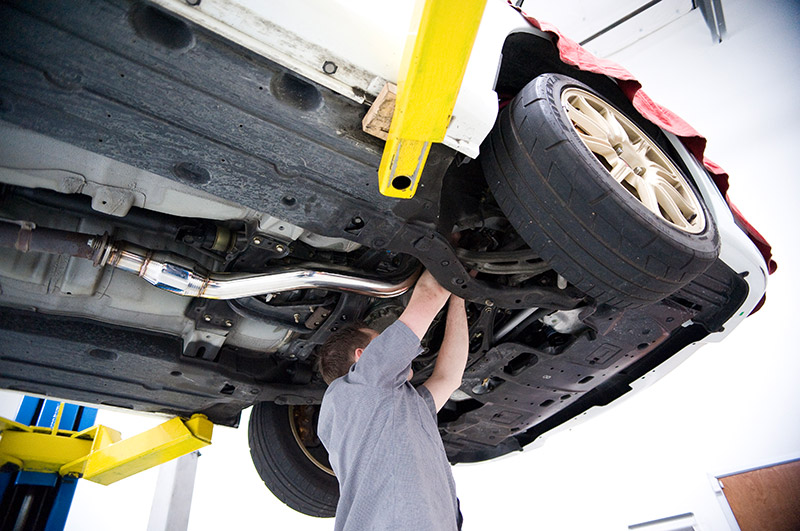

Calvin takes off the stock DP without removing the intercooler
taking off the stock DP probably took 20 mins total... no rushing
Cobb DP going on

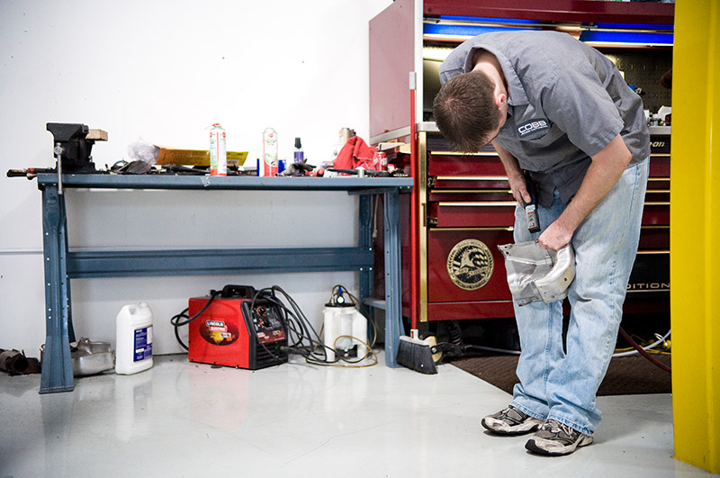

Calvin modifying my stock heatshield to fit
Pulling my car out to the Dyno... The Cobb time attack car looks so different and so awesome. I bet that thing is fun on the track!
Cobb cone Basher in the background
Tuning via laptop

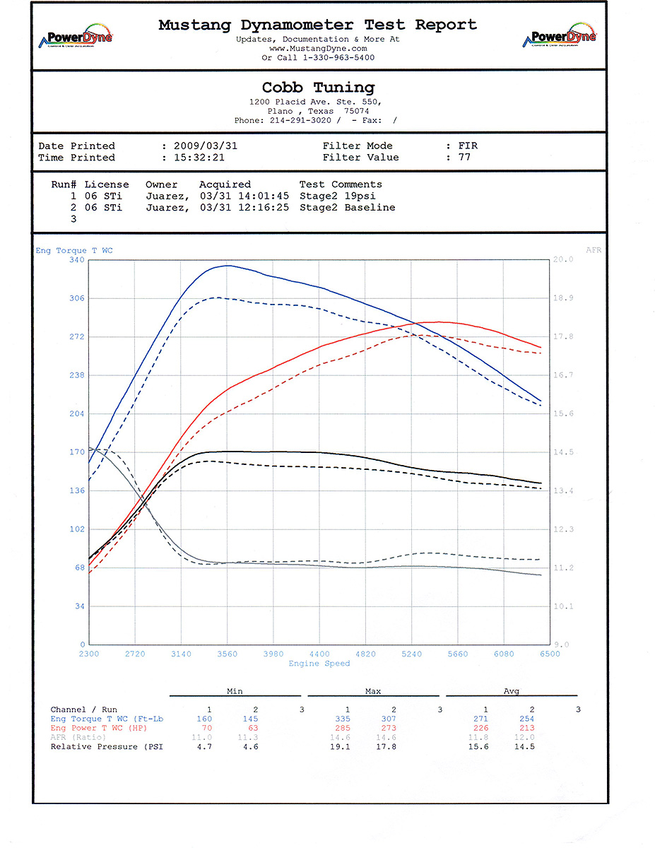

Baseline
installing Prodrive Solenoid
One of the pulls with 290.1 WHP and 344.4 WTQ (those are corrected numbers)
287WHP 344WTQ
Cobb shop
Neil is camera-aware
Shop talk
mmmmmm.... Big Stoptechs

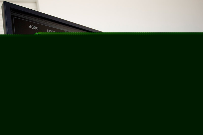

Finally the printouts. This is Baseline vs. 19psi map to use in cold-moderate weather and track
Calvin also made an 18psi map for me to run in summer or at the track. Here's the comparison.
So yeah, I can feel the difference now, but its not a slug of power or torque as I expected, as it feels much more linear than before with stage 1. And apparently, my stage 1 car was spiking the boost pretty heavily before so that's probably why the torque always felt so meaty before and doesn't feel night and day with stage 2 tuned.
Overall, I'm happy with it, and with the stock cat back I retain a stealthy sound for now. With the new DP though I hear all kinds of noises coming from the turbo and engine I never did before. ^_^
