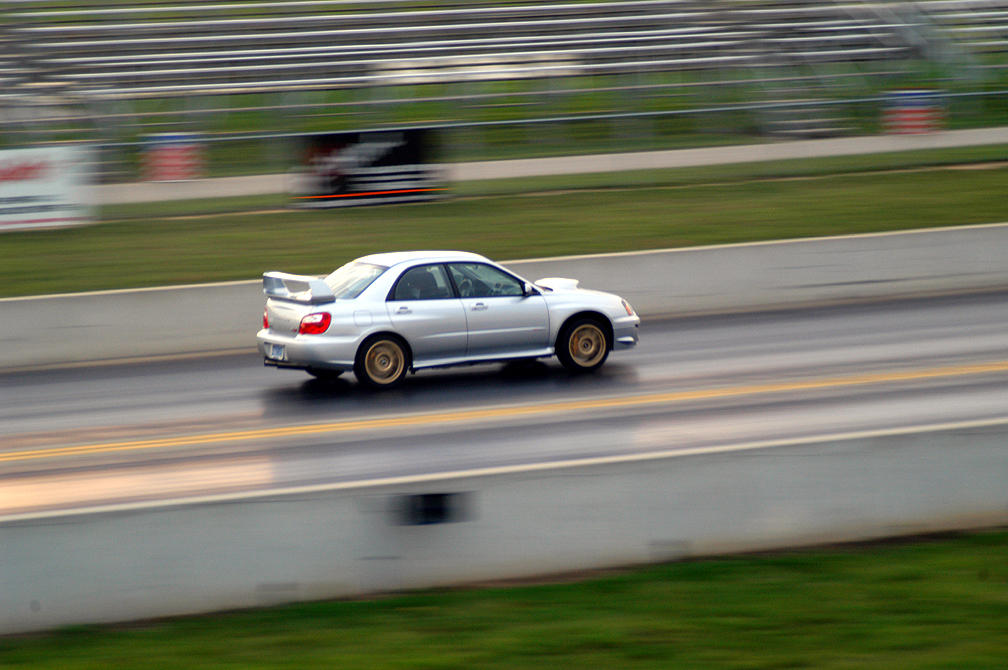

Default Photo of 1/4 mile pass...
Hey,
I just went through some photos that my 13 year old son took at the track... this one stood out...
