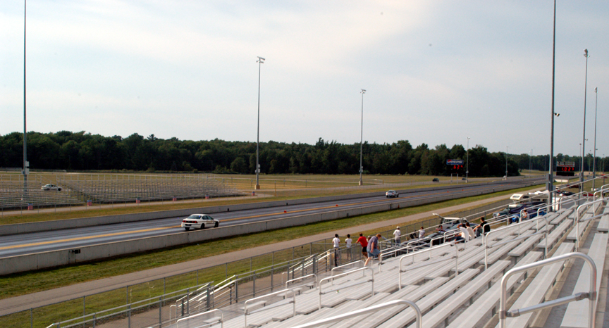

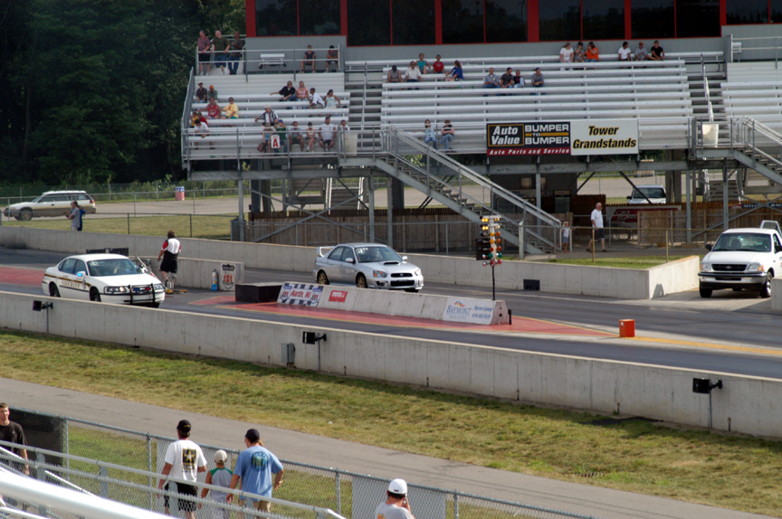

Went to the track on Sunday.. they were running a beat the heat race, I attached a couple of photos of me blowing away a cruser... see below>
Regarding the K&N performance... I am getting more air to flow through the engine... basically, I now have the same performance on 93 octane as I was achieving a few months ago with GT100 race fuel.
The timing advance is still messing with me but I am getting the 105+ trap speed. Was running 13 flat due to mega tire spin. Also.. I had trouble with the K&N loosening up and sucking air (after the MAF).. this caused ugly AFR's (12.5 to 1 )

Is that a actual cop car you blew away? That's so funny!!!
mug23 is offline   Reply With Quote

damn that is a nice pass. like the car.

That cruiser looks legit (still has lights on it). Is it some public relations vehicle, like the D.A.R.E. cars?

Yea, actual cop cars were there for the race... it was a blast...
I must admit it was a bit unsettling looking in my rear view mirror at 105+ and seeing the cop car with lights on trying to catch me...
