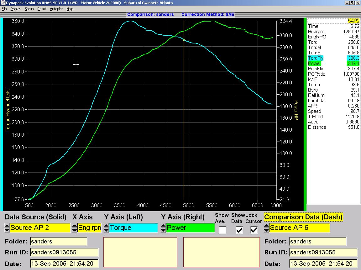

Stock injectors and 93 octane from down the street. Which now that you mention didn't seem to want to run as much timing as whatever gas the car came in with.
Really, total parts were Injen CAI, TXS (WRX) TMIC (I think they only have the one, and this one used the stock STi Y-pipe under it), Random Tech DUAL catted TBE, EBCS, Walboro, and Ecutek. The engine bay was HOT when we did it and we were hand spraying the TMIC with tap water.
This customer road races and this really would be a road race-able setup with a splash of good gas. 18.8 psi peak, tapering to 16.1, minimum timing was near 17 with 29 or so at the top...
This is a STRANGELY high car, but nothing unnatural was used to make these numbers. Like I said, the car ran better on the street than on the dyno.

Wolf, you are correct, I tried a little more boost to get the 365.5 wlb-ft 328 whp...

18.8 peak to 16.1 at 7k

95.96% is the highest that I am finding. That's with the DeltaDash logger, which has been shown to add fuel pretty well up to 118-120%...
It appears that they have "100%" set to 80% of static (true 100% - wide open)...

Thought I had posted that:
dang, having issues with the program.
the 365.5 was running 19.55 psi at 3400 and about 16.6 at 6800.
The 360.0 had 18.76 psi at 3400 and 16.1 psi at 6800. Fairly smooth between them on the dyno, PERFRCTLY smooth on the street.

Is it normal for the torque to drop that hard towards the end of the powerband?

Remember that the torque is shown ONLY on the left axis, the right axis is whp, which is different. It does drop to near 220, which is near 40 higher than stock. This is also the STOCK turbo, so it is WAY out of breath at 7k and 16 psi... (it was still running near 30 degrees of timing though, so it was happy.)
