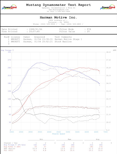

Baseline Dyno Testing
233WHP and 240TQ.
This is inline with 2004-2007 STIs on our dyno. No real surprises, although you can see the extremely lean AFR held until 3000RPM by the stock ECU. Boost was 15psi peak and held pretty steady until 6000rpm. AFR were 10.5:1 10:1 from 3000-7000 rpm.
HM Stage 1 Tune (Prelim)
We received a new Cobb CAN Accessport and Beta Protuning software last Friday. Big thanks to Cobb for getting this done so quickly! The software works perfectly, especially for a BETA version. Needless to say, as soon as this arrived I was on the dyno and the road testing
240WHP and 260TQ.
The only performance modification on the car is the Cobb Accessport w/ Harman Motive tuning.
I'm pleased with the results of our initial Stage 1 tuning. I raised the boost slightly (15.6psi peak), dramatically altered the timing map for smoother/more consistent performance, and adjusted the fuel map for more stable AFR of 10.8-11:1 from full boost to redline. I eliminated the delayed richening of AFR present with the stock tune.

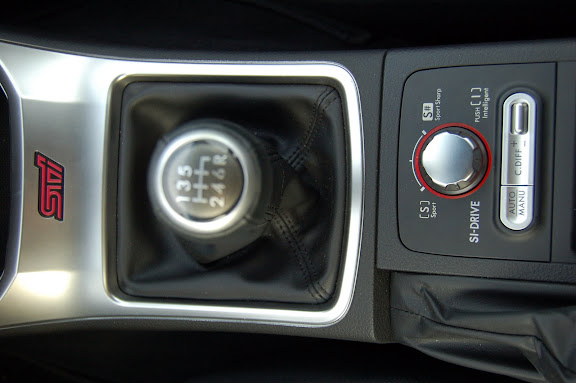

In the process, I completely reprogrammed the SI drive. Currently, the S setting is similar to the S# stock. I decided to leave I mode alone. The new Harman spec S# is my favorite, although it is pretty aggressive. I feel that that the adjustments to SI-drive have really improved the car and it now drives much smoother and feels WAY WAY faster (surprising given the modest power gains).
The car no longer bogs below 3000 rpm and gone is the choppy on/off power delivery between 3000 and 4000 rpm. The car also pulls smoothly to redline (now 7100rpm).

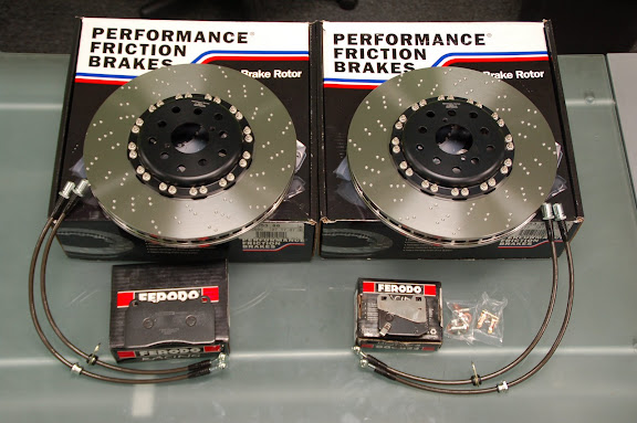

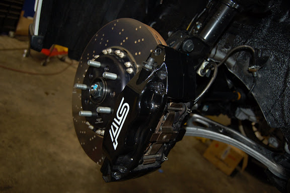

Immediately after the last track event, I knew we had to get a brake upgrade on the car. As with previous STIs, the weak braking is primarily due to the pads, lines, and rotors not the calipers. As such, you can perform an economical brake upgrade that gives you near BBK performance.
Our Stage 2 package consists of:
Performance Friction 2-Piece Rotors
Ferodo Brake Pads (DS2500 recommended)
Harman Motive 08 STI SS Brake Lines
Motul RBF600 Fluid
Braking performance was greatly increased with this setup. The lines and pads really do a number on the feel, you now get positive engagement as soon as you touch the pedal. Furthermore (and most importantly), fade has been greatly reduced.
